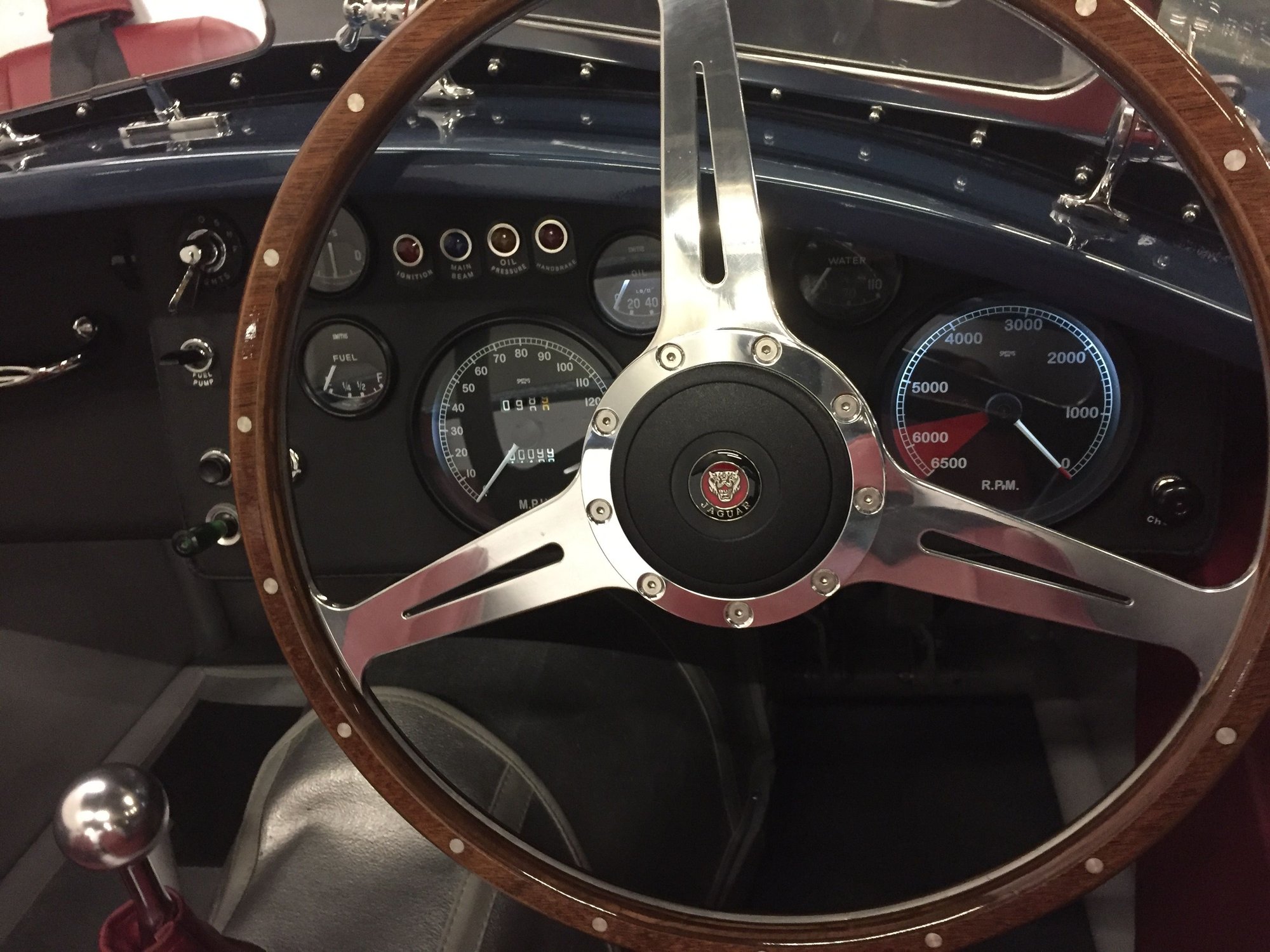

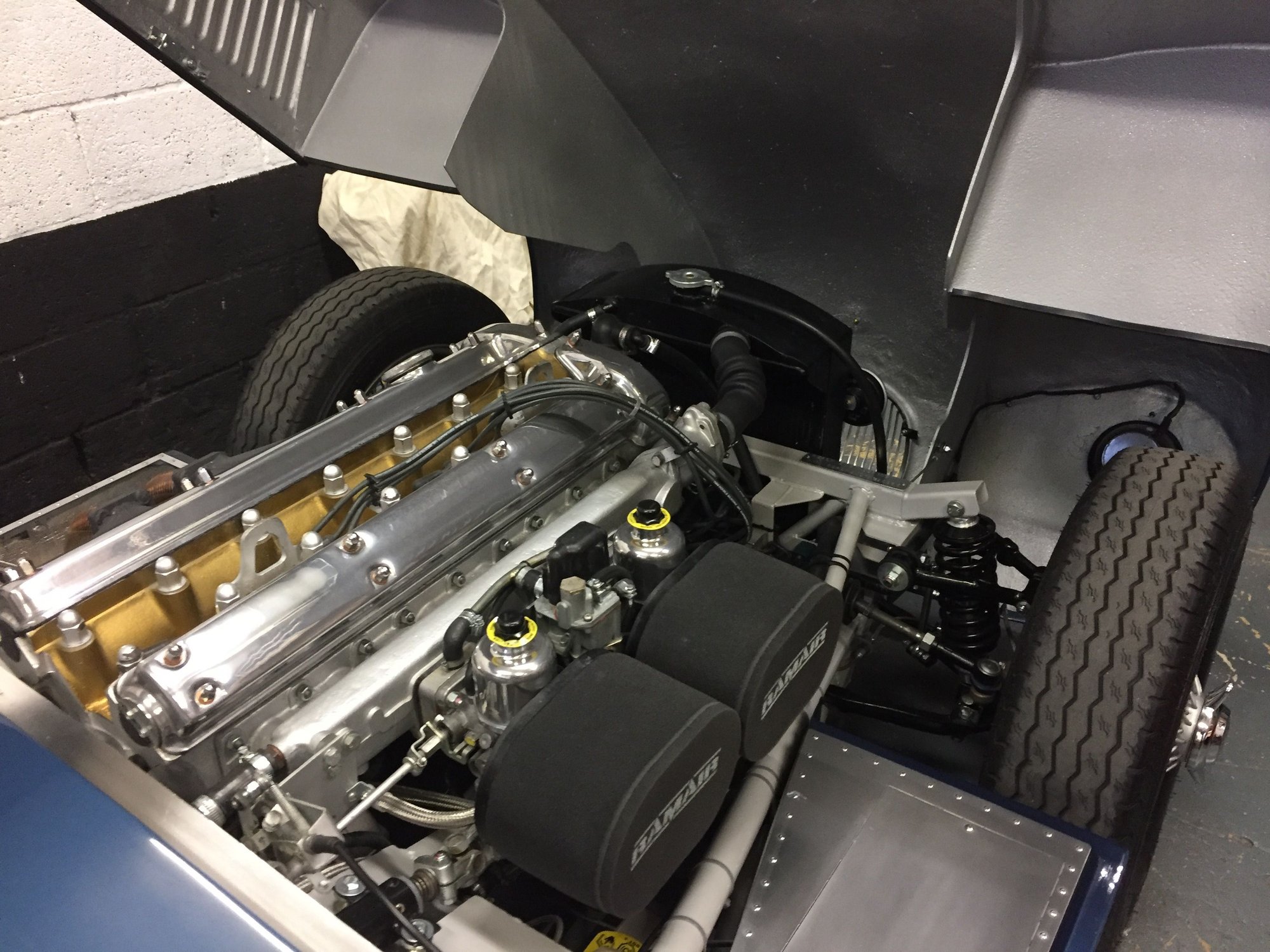

Default My other car
Should have stuck with this one that I built

That is a gorgeous Jaguar you have there my friend! I have always had a soft spot for the six cylinder engine.
I can't believe that your injectors were stuck like that! Congratulations on getting it to run again!!
