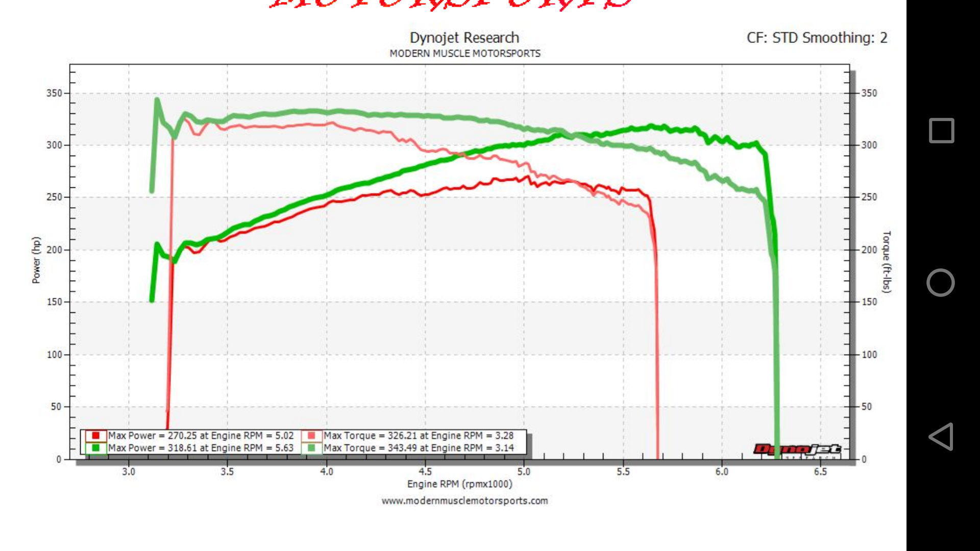

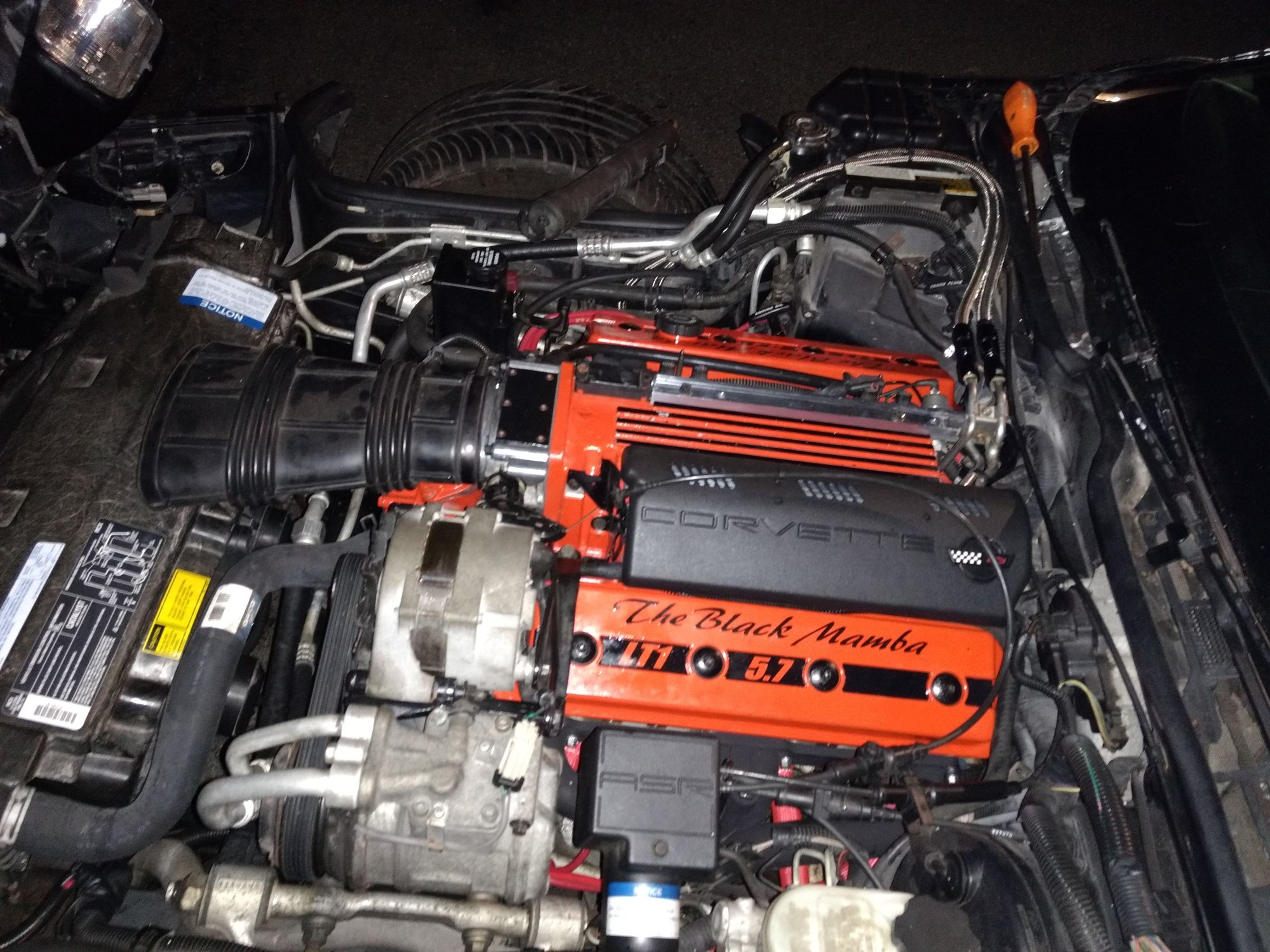

everything your doing with exception of cam bearings which I agree with others not necessary, can be done with engine in car. I did my cam swap and at same time I did oil pan gasket,water pump,
must do's(in my opinion) with cam swap
verify rear axle ratio will work with cam. the 2.59 is a joke
Cam, valve springs,hardened pushrods, valve seals,tune, I also did 1.6RR
If you didn't already buy cam you will be much better served getting a custom ground cam to work with your car. converter stall, rear gear all play a HUGE role in cam selection. custom grind is same price.
my car is custom grind, 3.54 gear, 2800 stall converter, all done in car.
good luck.
PS watch plenty of youtube videos on installing water pump drive seal. very trick(if not paying attention) I used the sharpie trick.
