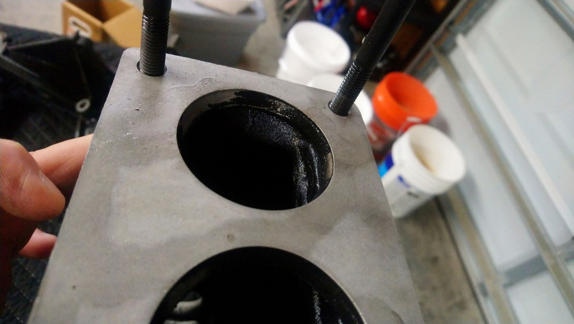

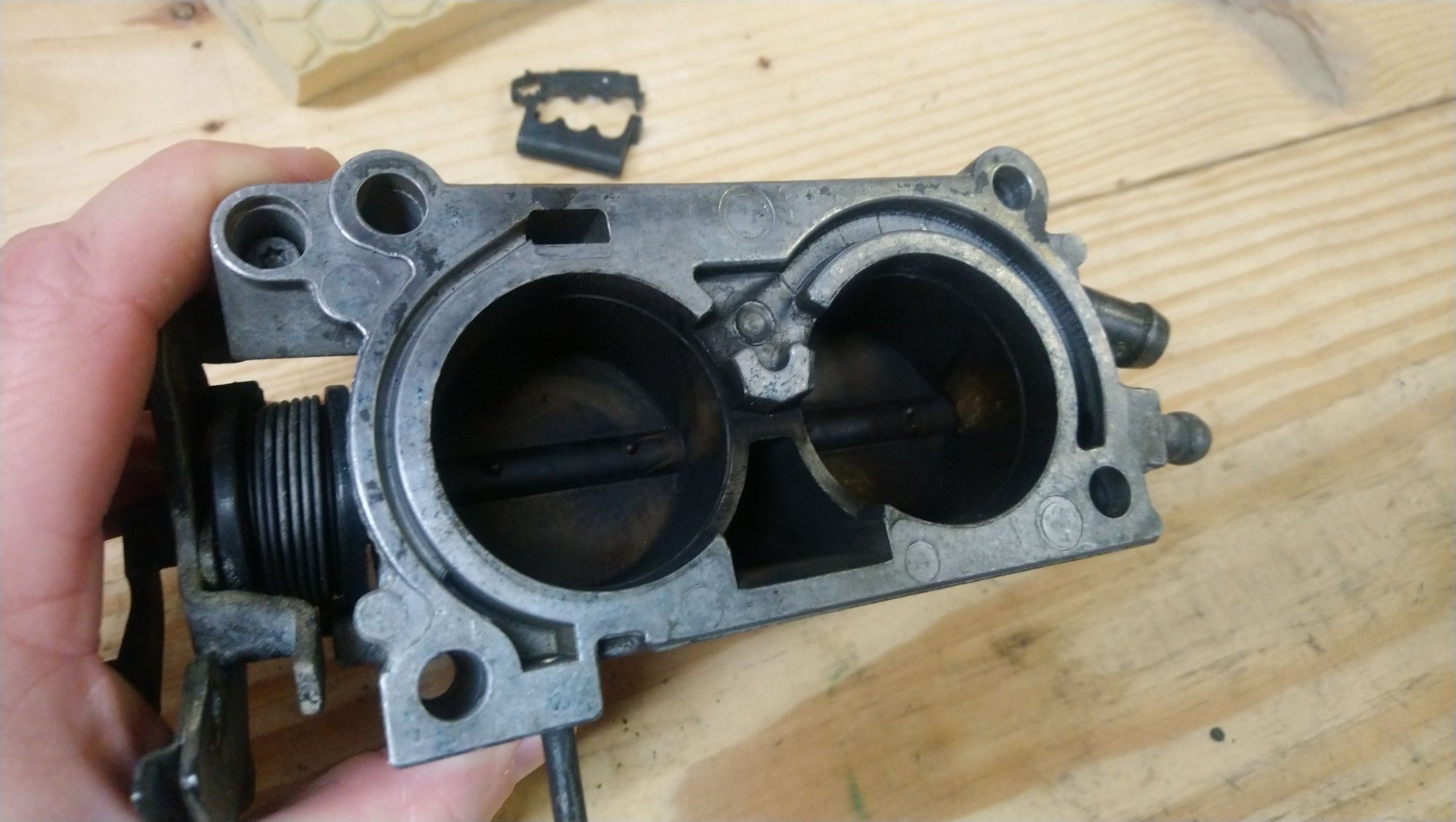

Hey gang,
I started out doing the injector replacement and my OCD got the best of me. This led to removing the entire intake and then removing the valve covers because they looked nasty and I wanted to freshen them up. This also led to removing the air pump assembly so I can do the air pump delete. Anyhow, some of my parts such as the throttle body, intake runners, and some miscellaneous brackets are covered in Grease because the previous owner never cleaned anything. I've included some pictures below but my intake runners the plenum are coated with carbon build-up on the inside. I did just finish completing my sandblasting cabinet and I am using glass bead to blast things. My question is some parts I soaked in a solution of simple green and water hoping to loosen up some of the build-up. Question number one can I soak my entire throttle body in this solution and do I have to worry about it hurting anything? Question number two what do you guys recommend as far as cleaning the carbon out of the plenum in the intake runners? Buying multiple cans of brake clean would get rather expensive. I'm trying to clean up some of these parts before I put them back on and I also want to sandblast the valve cover so that I can repaint them but I need to degrease everything as much as I can before I put it in the blast cabinet. What do you guys recommend besides brake clean and typical cans of engine degreaser? Thanks in advance for any info you guys might have.

Be careful cleaning the throttle body bores and throttle valve ODs. The factory put a coating on these to seal them at idle (so the IAC can accurately control the air volume at idle, I believe). You don't want to scrub this stuff off, or use strong solvents like brake cleaner on them. Use throttle body specific spray from the auto parts store on these areas. There should be quite a few threads about this if you do some searching. Also, you should check your throttle shaft bushings for wear. If these bushings are worn, it will give you intermittent high idle as the plates tend to stick just above the hard stop and you need to 'blip' your throttle to get the idle speed to come down. I bought an NOS throttle body to solve this idle problem on my 95. I measured the radial play in the shaft (at WOT) on the new throttle body, with the idea to re-measure it on the old one I took off. I don't have the measurements handy on the new one, but I can find them, if you are interested. I haven't measured my old throttle body yet, but I can get that number too. Good Luck!
John
This is the section from the FSM on throttle body cleaning. Removal of the DAG can result in throttle plate bypass and that can result in a high idle situation that the IACV cannot compensate for.

Thanks all. I did use the pressure washer today and it helped get a majority clean enough to put them in the blast cabinet. I plan to spray high heat clear coat on the parts once they have been blasted, except the valve covers, those are being painted with a black wrinkle finish to help cover up the piiting anf finish issues of the original valve covers.

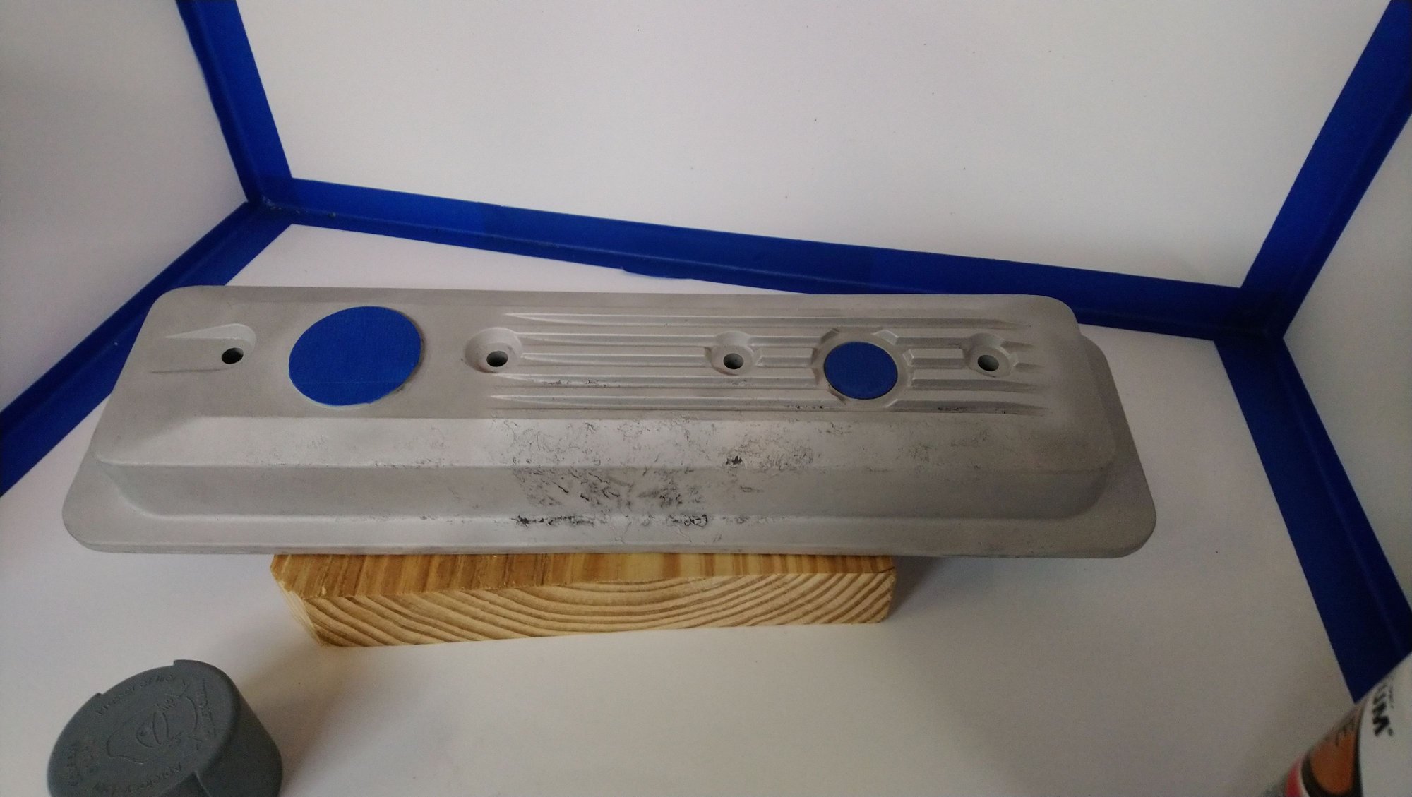

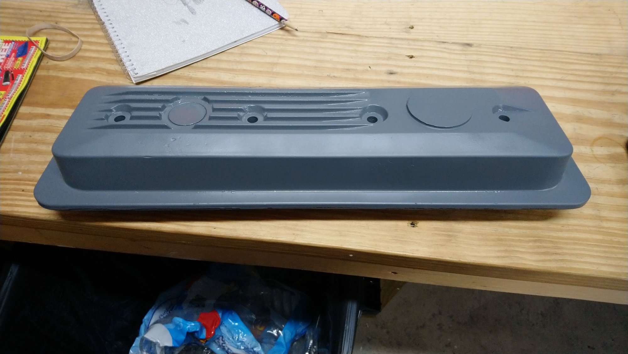

I was able to finish the valve covers today. They turned out pretty good. I sprayed the clear coat on some of the other parts but I don't have pics yet.

vc's look great. did u leave the wmblem on the vc and cover with blue tape or whats the blue stuff?
if u r trying to save the coinage like i was, i used my kids paint and teeeeenie brushes and even a toothpick to dob paint on. worked amazingly well! then i cleared it all with a 2k clear coat in a can.

I used the blue tape to mask off the PCV valve holes and the area where the emblem is supposed to go. The old emblem fell off a long time ago. Sometimes it he so doesn't stick very well to paint so I wanted those areas to be bare.
