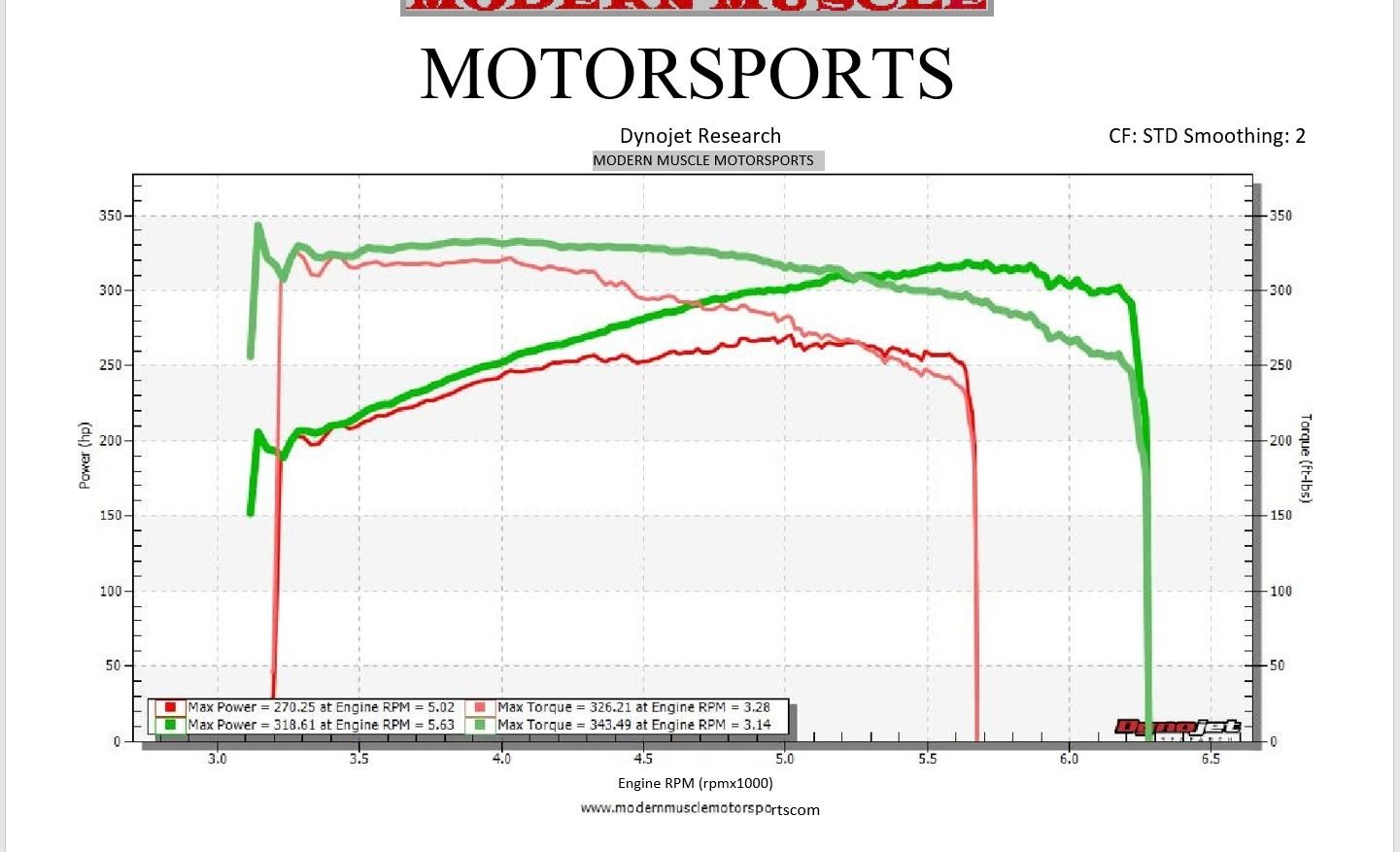

That duno chart looks very suspect. Torque stops at 5700 RPM like they stopped the test, but HP is recorded out to 6250?

The graph is my dyno results

Is the graph showing the Cam and the headers or just the headers added to the engine? How much of an improvement over shorty headers are you expecting? I have not tried to use any headers on my 1988 C4 as I have the infamous L98 which needs way more than just headers to make any significant power.

Graph is my dyno .It's stock vs cam overlayed. I had dynoed before and after cam. Both runs have shorty headers. I'm not as concerned with hp gain on LT as much as better total system. Currently have cheap shortys that make it impossible to change plugs and stock cats X-PIPE with muffler deletes. I have a Borla cat back system to go on with new lt's .Eliminating cats

You got ~50 hp from a CAM ONLY? Meaning...just a CAM swap? I'm asking b/c on the C6 forums "cam only" actually means:

Yes I got 50 hp from Cam. at cam swap I did 1.6 Lunati Voodoo RR, cam, springs, hardened pushrods and that is it. car was 1st dynoed (red line) with stall converter, shorty headers and resonator delete with Xpipe and muffler deletes, dyno results 268whp then re dynoed after cam swap and rr and 318whp (green Line) cam is a Lloyd Elliot custom grind. second video has cam specs.
car ran 14.2 @100 bone stock with 2.59 gear.
car ran 13.2@103 with stall converter, 3.54 gear and exhaust
car now runs 12.6@108
