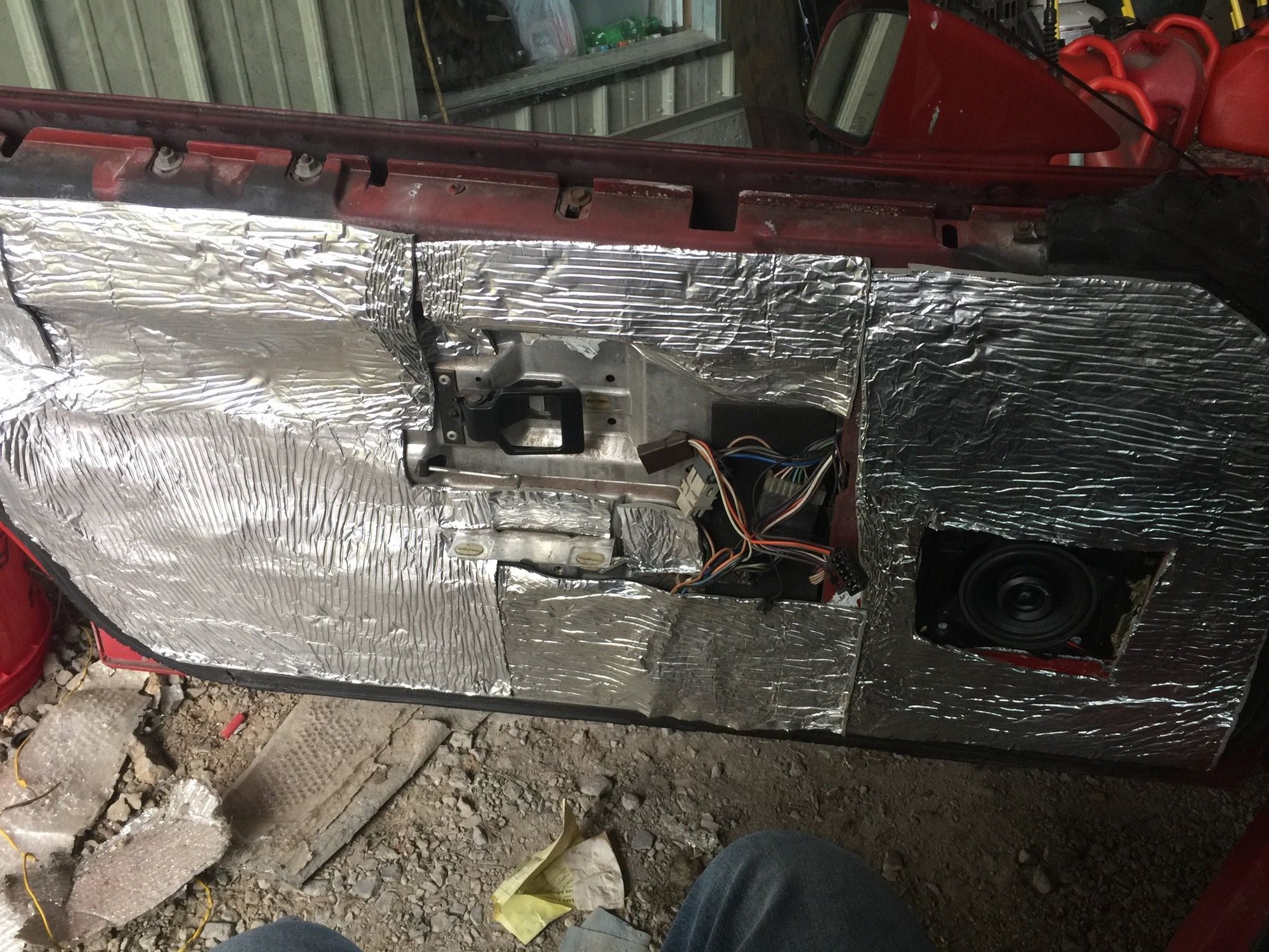

That looks like it yes.
Don't expect a miracle. It helps but it won't be gone completely. It really helps quiet the vibrations though.
In places where you can, I definitely recommend doing at least two maybe even three layers. Especially in the back hatch area.
I added a photo above of what my door looked like after install. It "thunked" closed much more satisfyingly after this.
