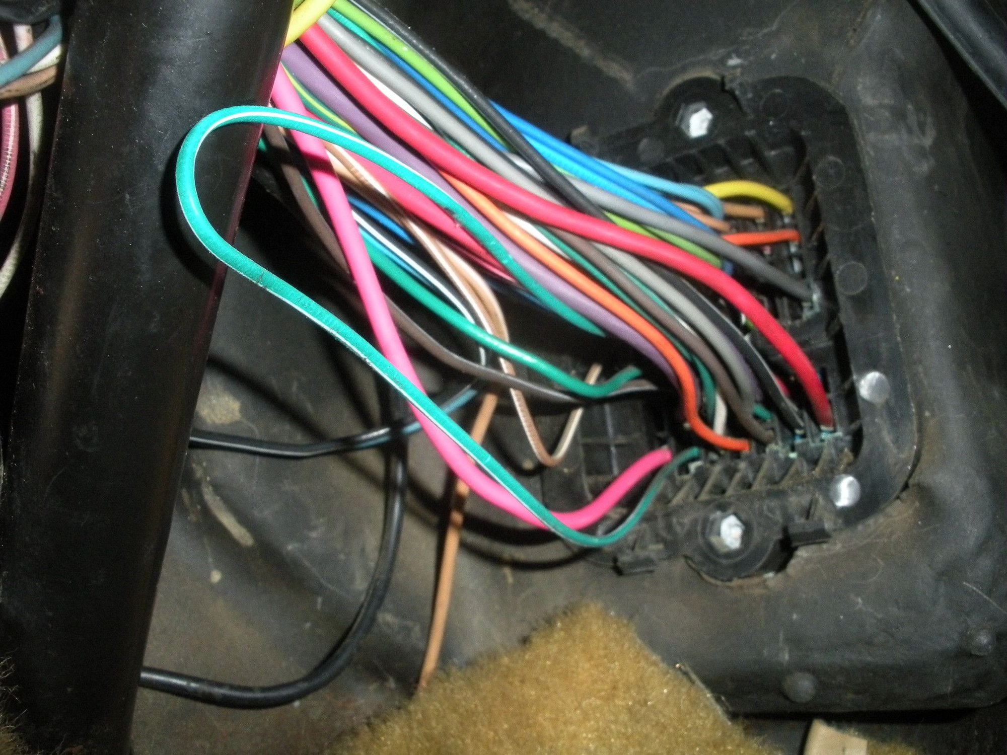

In the '84, if you want to install a switch on your dash panel to control your fan (which wouldn't be necessary if your fan components are working properly), this can be done without running any wires thru your firewall! The wires are accessible under the dash. This grn/wht wire at C115-7E is the wire that controls the fan relay. Ground that wire and the relay will actuate. You can also use that same wire to illuminate an LED to let you know when the relay has been actuated by the CTS, and the fan is running. My '84 FSM calls this wire grn/blk, but it's grn/wht in my car. For years other than '84, check your FSM!
Fan Relay Control Wire.

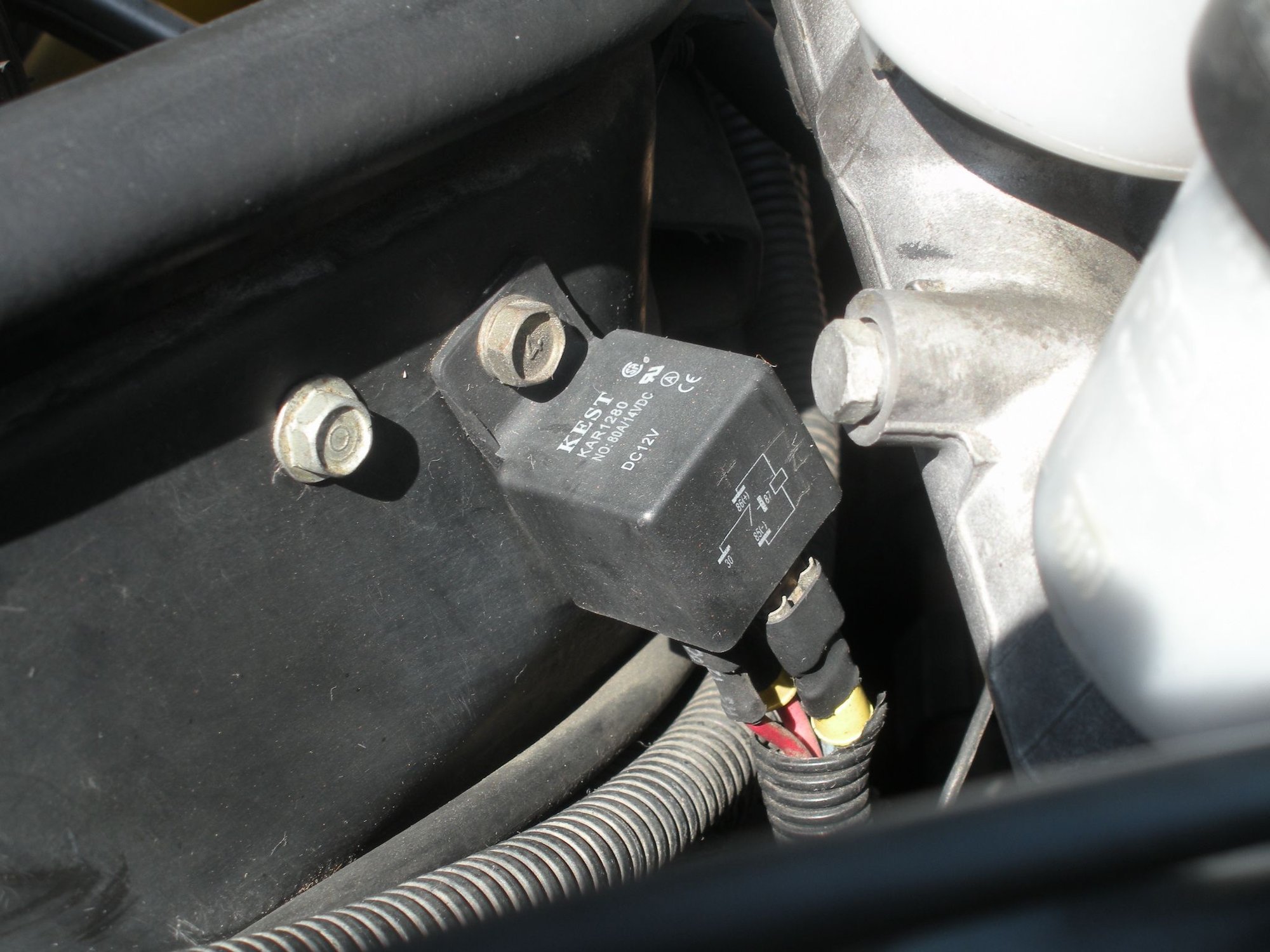

It sounds like you do not have a copy of the FSM (Factory Shop Manual). You definitely need these two books! The Electrical Supplement (book #2) is excellent! The CTS for your '84 is located in the RH head, between spark plugs 6 & 8. Installing an ACDelco D1855B CTS would have your fan turning on at about 215, and off at about 200 deg. The fan relay is located on the LH fender panel, below the master cylinder.
Custom Radiator Fan Relay
