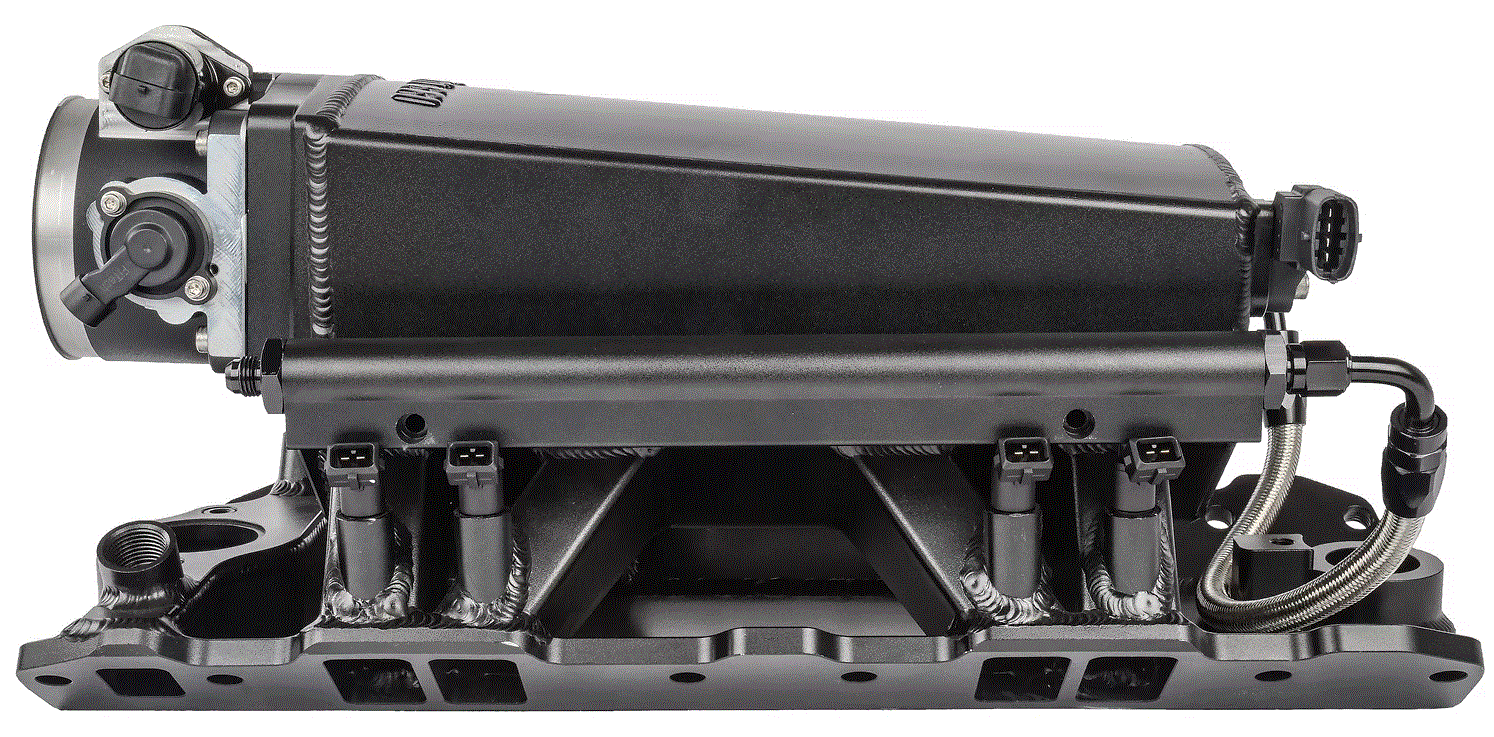

Anyone know if the fitech ultra ram fits under a stock hood? https://www.jegs.com/i/FITech-Fuel-I...iABEgJ3KvD_BwE
I know the holley stealth ram don't fit but didn't see anything bout the Ultra Ram yet.

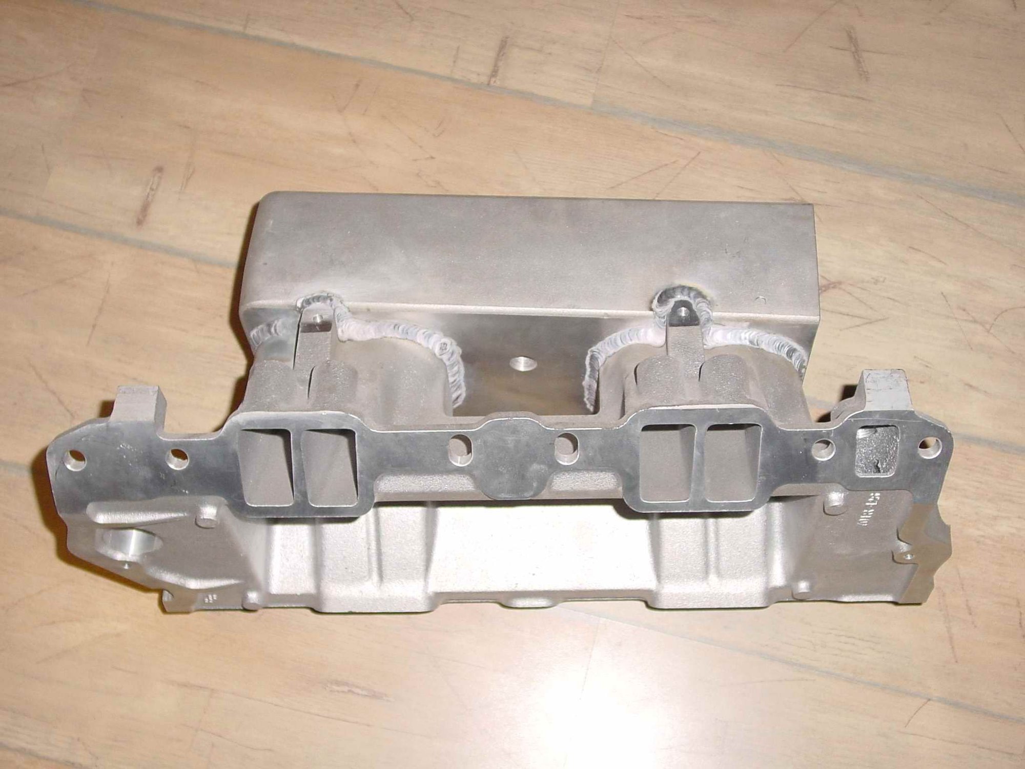

From Q&A:
The manifold as show in the picture is approximately 9" tall.
According to Google the Holley Stealth Ram is 10.1 inch high.

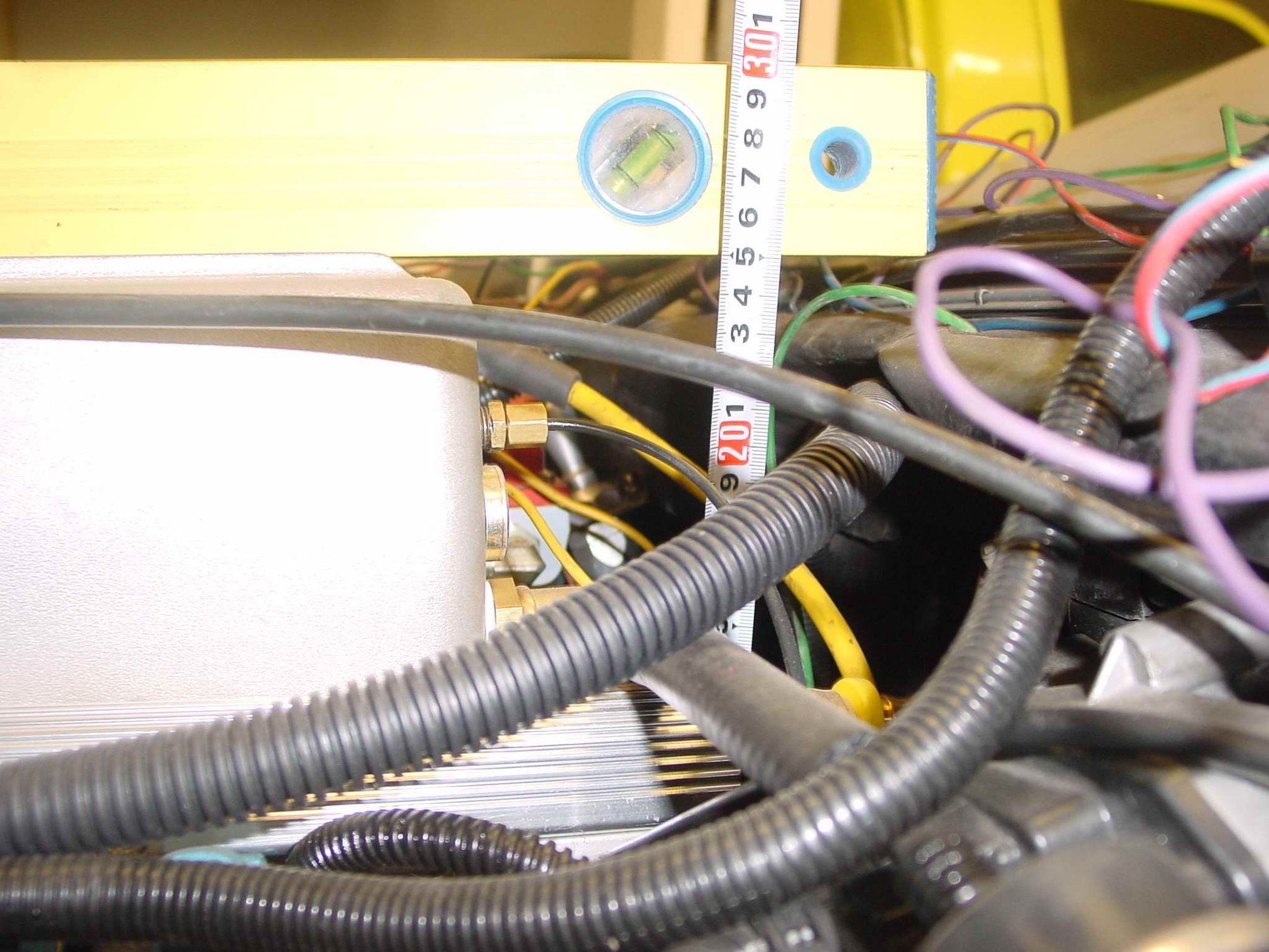

This is my modified Holley Stealth Ram compared to a stock one.
As you see it was 2 cm = 0.8 inch too high at the front. About 1 inch to get some minimal margin for movement.
Fitech Ultra Ram is going to be close but it might clear the stock hood.
10 cm = 4 inch
8 cm = 3.15 inch
25 cm = 9.85 inch
22 cm = 8.7 inch

Doubt it.
FiTech answer on Summit says: " The intake is 9.75" tall. "

Is that only intake or with throttle body? It might be possible to mount that upside down or add an adapter to angle the TB down.

No idea. Probably have to contact FiTech to get a schematic or something. I don't think their tech department even knows the actual answer.
They gave some weird answers like: " The manifold is 4.58" tall and the throttlebody is another 3.25" tall."
And then also give the 9.75" tall answer.
Edit: It most certainly looks close when you compare a stock TPI to it. What is a stock TPI height? ~9"?

Wow what a crappy place to put that idle air valve solenoid, someone should redesign the throttle body. Curious if anybodies 102mm throttle body would fit? Looks like Fitech is using the typical TPS and IAC.
