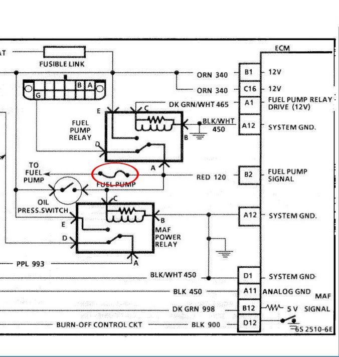

The diagram from the 88 FSM definitely shows that there are only two ways to get power to the fuel pump fuse. See the attached diagram out of the 88 Electrical FSM.
1. If power is supplied during start only through the fuel pump relay or
2. When the oil pressure switch is closed with normal oil pressure.
File Type: pdf
I see oil Pump and B2 of the ECM.
