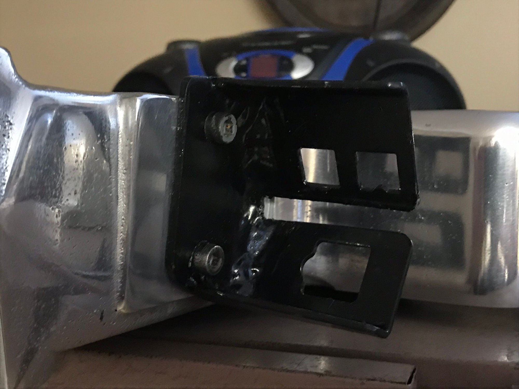

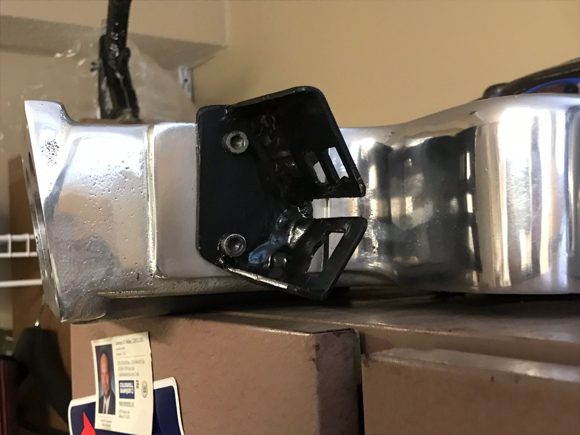

I searched but wasn’t able to find a cable bracket for my super ram so I ended up cutting a regular bracket up and made my own.
Needed to change the angle of the TV cable coming under the Superam, and moved the throttle and cruise section back a touch.
I ended up splitting the top and bottom and welding onto a new back plate I made.
Not the prettiest but it works!!

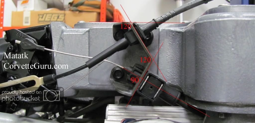

Has anyone made a drawing of this part? Something that would indicate the bracket angle, throttle and tv cable hole positions and mounting holes relative to those two features? I'd like to get my hands on such a drawing. I have CAD software but no part to work from.

Here is a pic from website I found that shows the Superam bracket with some angles...
