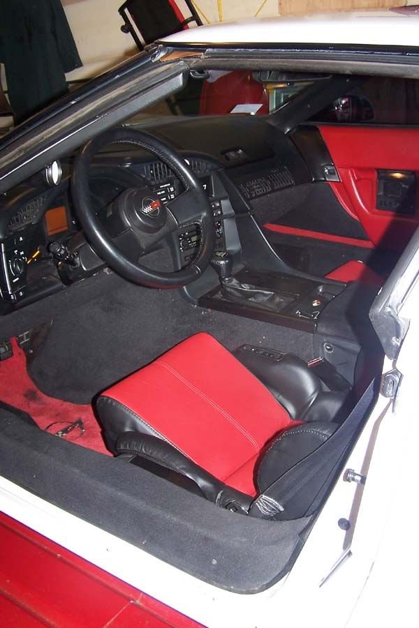

89 with 1991 dash:
I use the electronics and plastics from the 1991 column on the 89 column
1987 Column in 1990
I preferred the Momo wheel to the 80's Vette wheel.

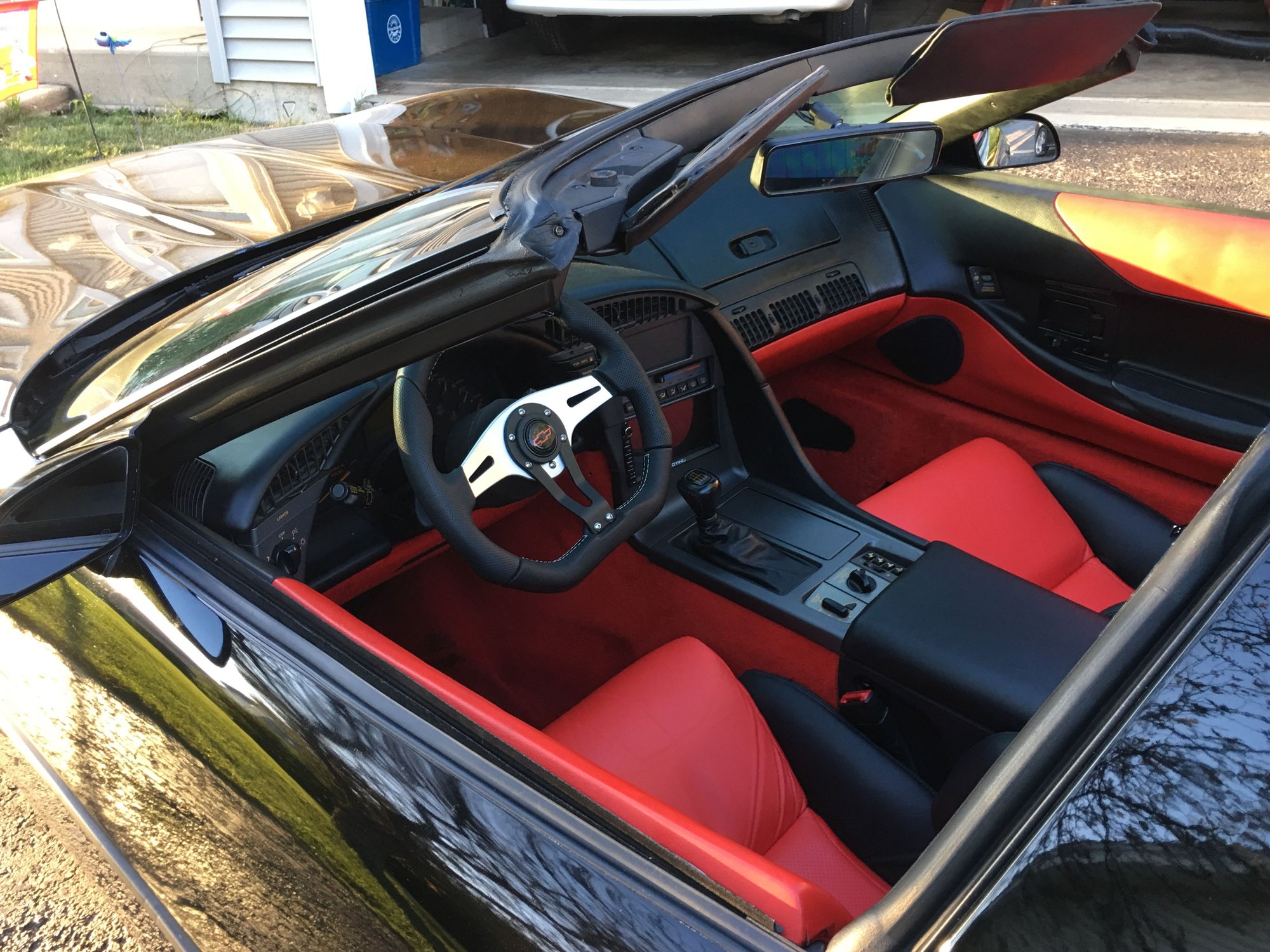

This is on my 1990 ZR-1, I had this aircraft style made on a water jet 1/4 aluminum,stock diameter, handles are from an knife company, red buttons are for the horn.
steering adapter is from sparco with a spacer to get steering wheel set for comfort. I donot autocross or track my car. Some drag racing and just cruising on goood days.
