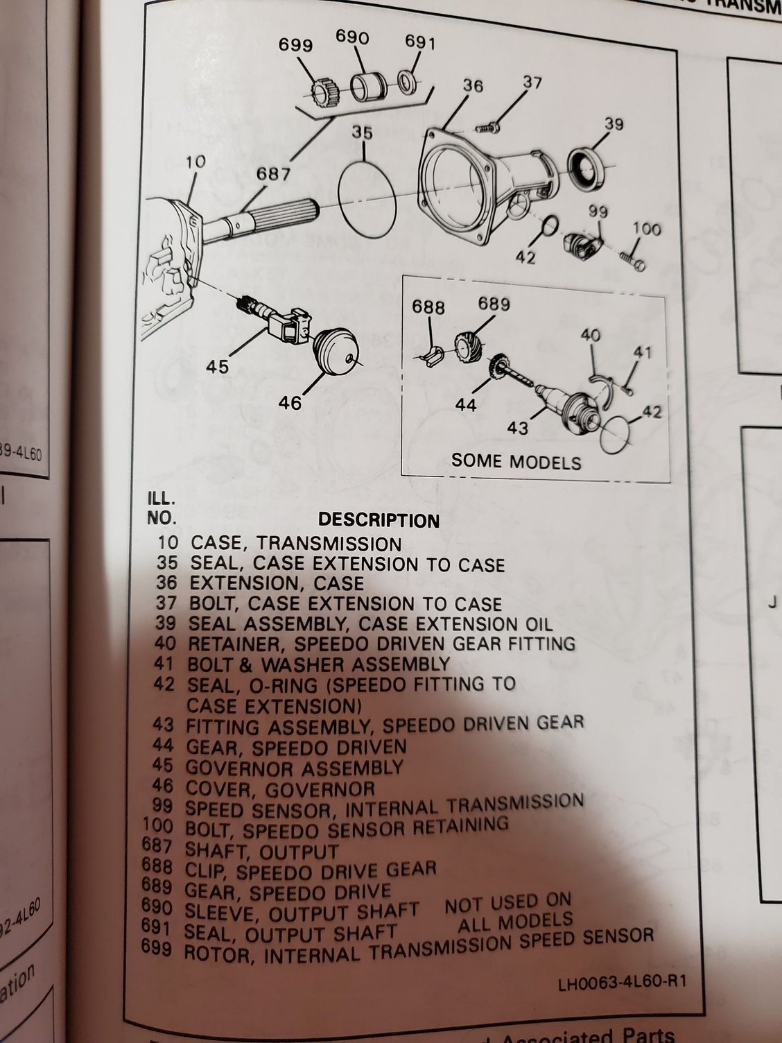

I have a 91. I have a drive and driven speedo gear and the driven gear is attached to the VSS. I have confirmed this with the FSM so if you don't, something is off. Either it is somehow modified or your year is off.
Old Mar 22, 2019 | 09:00 PM
aklim's Avatar
aklim
Joined: Jul 2004
Posts: 28,464
Likes: 3,288
From: Hartford WI
Old Mar 22, 2019 | 09:21 PM

To set vss for 3.45 you need the m6 speedometer gears and vss or you can try to rotate the A4 vss for larger speedometer gear. Lock fork will not line up with sensor dimples. There is also speedometer converter which canbe wired in. I looked in to it, but changed speedometer gears instead.

Thanks WVZR-1, I got into it today and it has the gears driving an electrical pickup. I got the 15-40 using a calculator on TCI's site. I have 295/35/18 rear wheels and tires and when I use their calculator is comes up very close to 15-40. And you are correct, I can find the 15 but the I can't find the 40. I think I'll get the ERA and wire it in.
