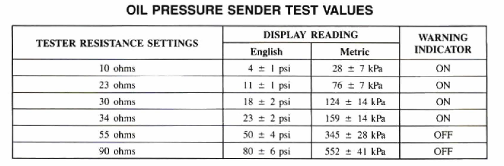

Values from an early FSM - If you get good values from the sender terminal maybe you've A/D converter problems in the cluster.

After checking the ohms
Idle 600rpms reads 42-47
2500 rpms read out jumps anywhere from 50-100 erratically.
Im sure it shouldnt bounce around so much but gauge still pinned at 80..what i dont get is the gauge worked before sw.apping out sender.Im not a beginner
with cars..But this isnt making any sense..I really doubt the gauge in car quit the same time i swapped the sensor
