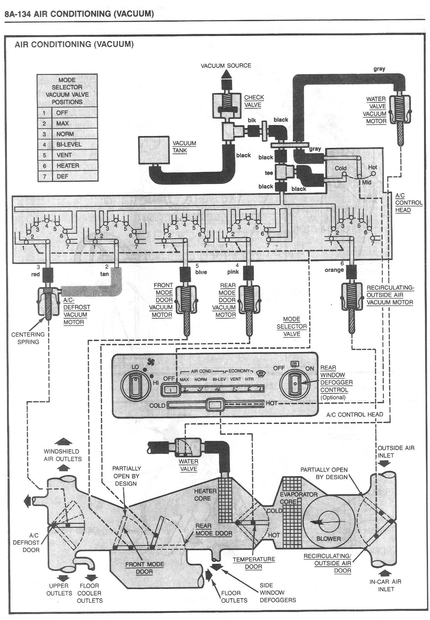

Turned the heat on the car today, and had a rougher idel vs the rest of the ac settings. When I shut the car off I could he what sounded like a huge air leak in the heater core. It didn’t make this sound until I turned the heat on. Is it time for a new heater core? Would keeping it in max ac mode bypass the heater core.

None of your description would indicate a bad heater core. The lower heat control lever in your '84 actuates a vacuum solenoid that is located at the water tubes to the right of your air conditioning unit under the hood (on the firewall). The upper control lever for the a/c has nothing to do with this vacuum solenoid or the heater core.
Try this: Raise your hood and start your engine with the dashboard "heat" control lever "off". Note the position of the arm on the vacuum solenoid. Move the dashboard heat control lever to the middle of the "heat" position. Does the arm of the vacuum solenoid change position? Is that where the leak is located?

The rough idle may only be the difference between the A/C compressor being turned on and off. The leak sound may be the A/C refrigerant equalizing. Both are somewhat normal. I would look to see if the car is due for a tune up or if there is anything wrong with the idle control system.
i thought by putting the ac on the “max ac” setting it closed off the heater core?

When you say "closing off the heater core", are you talking about closing off the air flow, or closing off the water flow? Guessing about how the system works won't cut it. You need the FSM.
The only time the water flow is shut off is when the temp lever is in the "cold" position. The water flow is either "on" or "off". There is no "in between". The upper lever on your control panel has nothing to do with the water flow . . . . Period!
I'm trying to answer your initial question: "Is it time for a new heater core?" The answer is "NO"! You may have other vacuum control problems, but you don't have a heater core problem. It's easy to get distracted when you don't understand how things work!

I am talking about the water flow shutting off in the max ac setting, funny thing is, been running it on max ac today, and I don’t have any problems. Try turning the heat on when you have it on max ac and let me know how that works for.

The "max a/c" gives you recirculating air, rather than fresh (outside) air. If you don't believe the FSM, I can't help you. Good luck. Good bye.

The only time this acts up is when I turn it on the heat setting on the top, why would it only do it then?

IDK what the heater core has to do with the idle. If it leaks, you need a new one. If it is plugged and cannot flow free, you need a new one if you tried back flushing it and no success.

Not really worried about the idel part, more worried about the noise it makes when I shut the car off on “heat” mode. Coolant system doesn’t do this when I leave it on max ac. Might be a plug in it like you said, but for now I’m not too worried, I leave ac off or max ac and it doesn’t do it.
