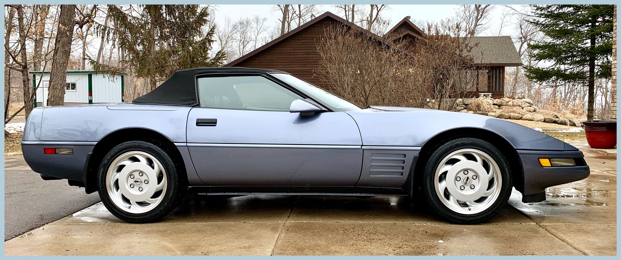

good looking rims are kind of hard to find really from what i found, a lot of the new rims are not really my taste, i ended up buying the rims the previous owner had which are a zr1 replica i think, for the 91 model, they look decent but it is also pretty common. i really wanted a set of weld wheels but when i saw the price i about choked on my coffee, 2 grand for 1 rim, my wallet said not going to happen. i can show you what a 91 vert looks like with them if you want a visual. only pic i have now is one while it is up on jack stands which doesnt really show it well since the tires are hanging in the air
