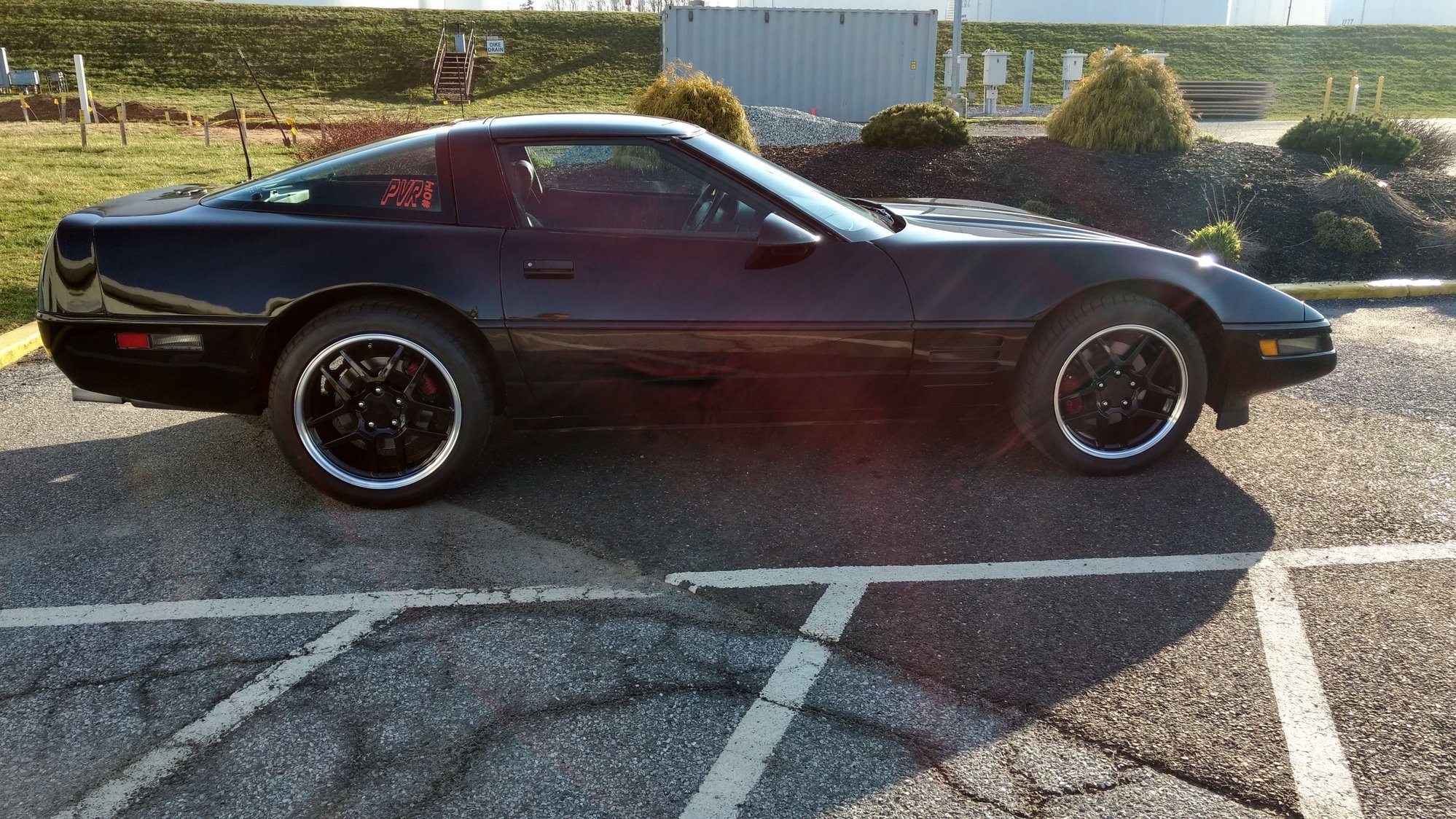

I've replaced my stock springs lowering my car 1 inch and replaced my rims with 18" on my '95. Now I'm running 275/40ZR18 front and rear. I have a spreadsheet that does the conversions so you can see what tire size you need to keep the same or desired height and width. Here are the equations:
Sidewall height = [Width (275)]/100*[Aspect Ratio (40)]/25.4 (conversion factor) = 4.33"
Width: [Width (275)]/25.4 = 10.83"
Total diameter: [Sidewall height (4.33")] *2+ [rim diameter (18)] = 26.66"
You don't have to keep the same offset. If you upgrade your front brakes to the C5/C6 style you do need to be cognisant to ensure your calipers will clear.
Here is mine with the lowered stance.

Your car looks great!. I was debating larger wheels in the rear vs front but after seeing yours the 18’s look great. What tires did you go with?

When I bought the rims, used, they came with rubber already on them. They are Goodyear Eagle F1s. I don't have any complaints about them.
