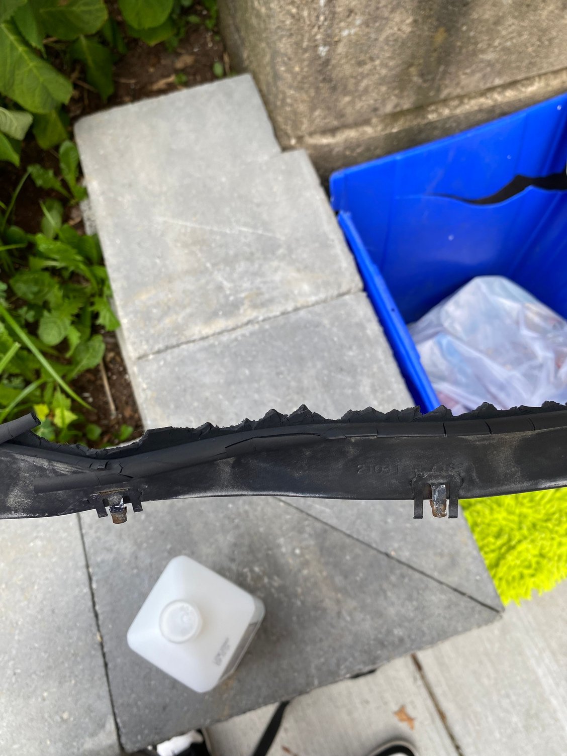

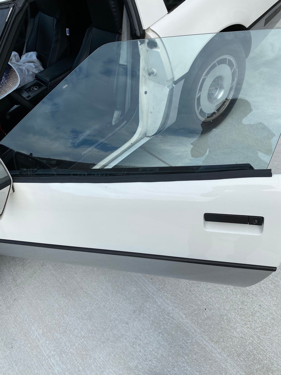

So I just did one side today and wanted to share my experience. I have an 87 btw.
Started with taking off the door panel of course. I then lowered the window all the way down to get access to the rivets.
I got my drill bit (a little bigger than the hole) ready with some electrical tape and wrapped a decent amount around the bit about half an inch from the tip so I wouldn’t go through the door. When I realized that the weatherstripping was in my way, I grabbed a rag and put it on top of the weather stripping so the bit would be spinning against the rag and not shredding the weather stripping.
With both rivets drilled out, I started pulling the outter trim off with some force and in an upward motion. You’ll have to wrestle it out but it can be done pretty simply. After I removed it, I cleaned the surface with rubbing alcohol and heated it up a bit with a heat gun to get it ready for my replacement option:
https://www.ebay.com/itm/14412949272...mis&media=COPY
Its simply just a roll of a seal looking thing with some double sided 3m tape and I think it worked great. I stuck it on so that the edge touches the window and it seems to work well. I’m going to attach a picture as well. Overall, I only spent $12 and it took about 30 minutes for a door. Could’ve put them on a bit more straight but it was 93 while I did it so I rushed haha
If it ever rots I’ll just buy another roll and stick it on since I don’t have to remove the old one again
Cheers
