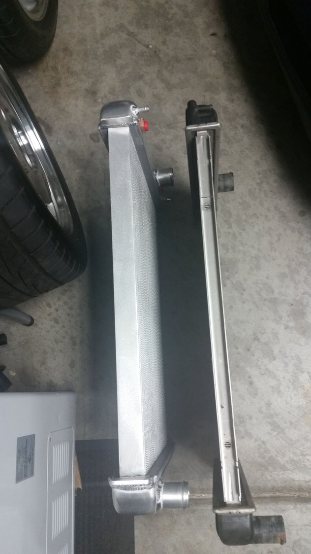

Hello, can anyone tell me how important the foam that comes with the radiator is? Looks like it would make it more of a pain to put the shroud back on. The reason I'm asking is I already installed it without it and the two plastic strips that were in the box. Everything lined up good. There were new bolts too I didn't use. Will it be okay? Thanks Mike

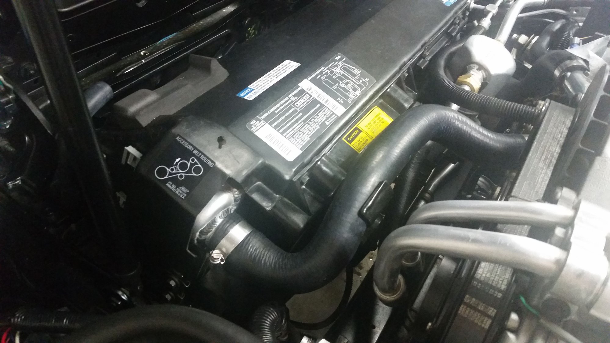

I think I'll pull it back out and put the foam on it. Might as well do it right. Thanks for the information
Old Apr 27, 2019 | 06:22 AM
helives4u2's Avatar
helives4u2
Joined: Jan 2014
Posts: 193
Likes: 16
From: Vegas NV

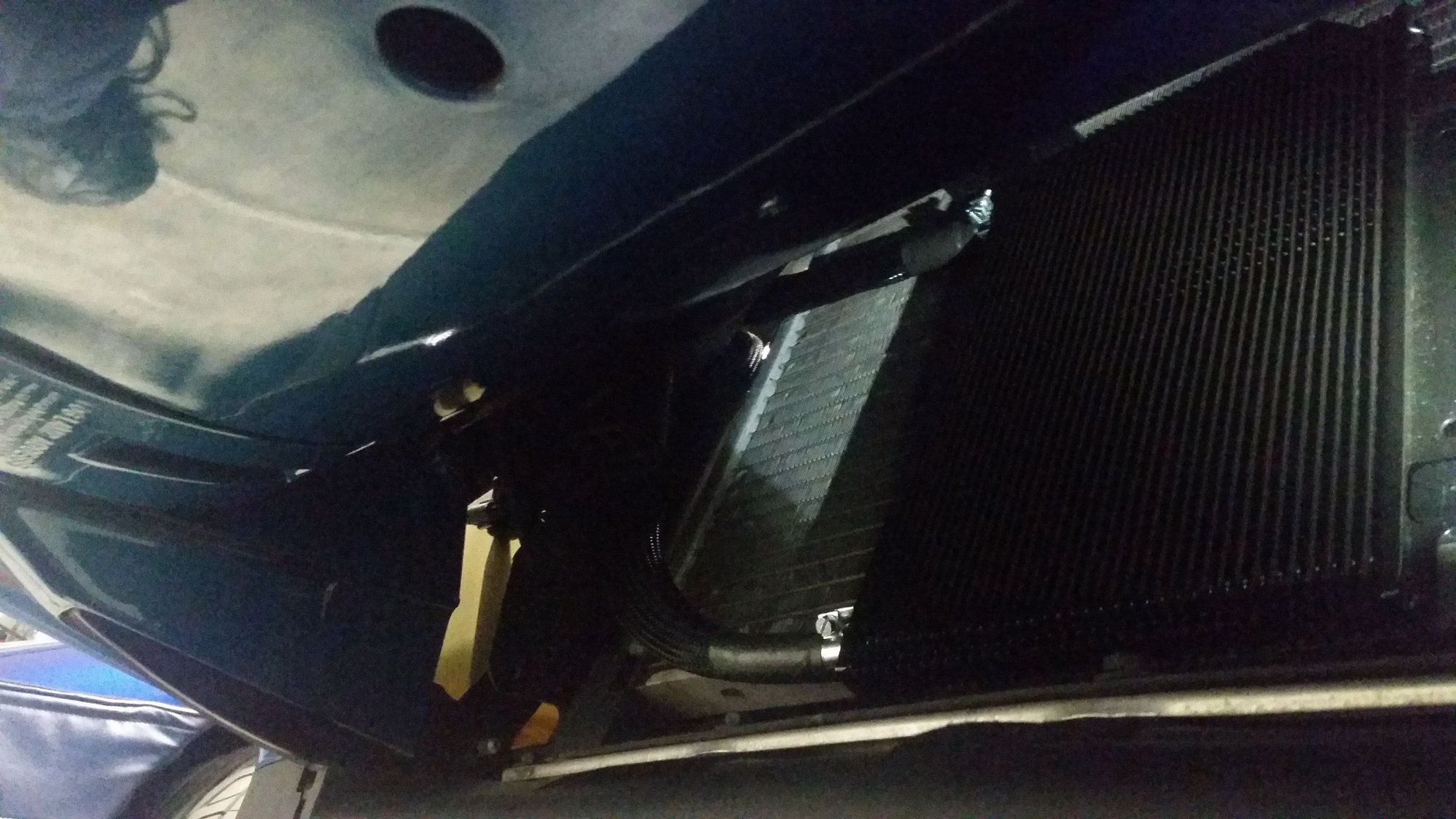

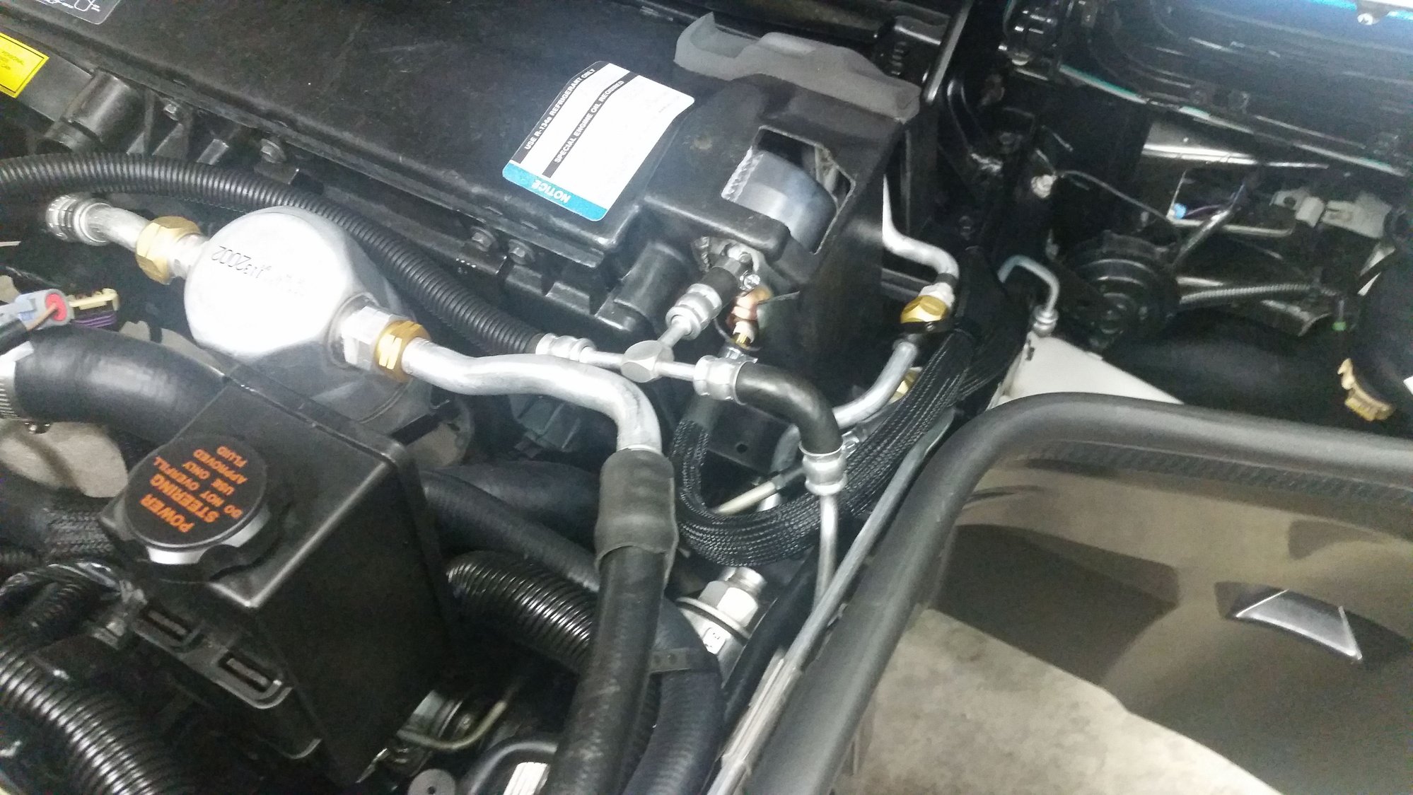

Okay, done right this time, I'll never attempt to do any project on my car before work, man was that sloppy! Installed the Trans cooler too.

Well, between the Dewitt's and B&M cooler the trans temp is down 38 degrees. It was getting to 212 @ 70 outside temp, today its 95 outside and it reached 174.
