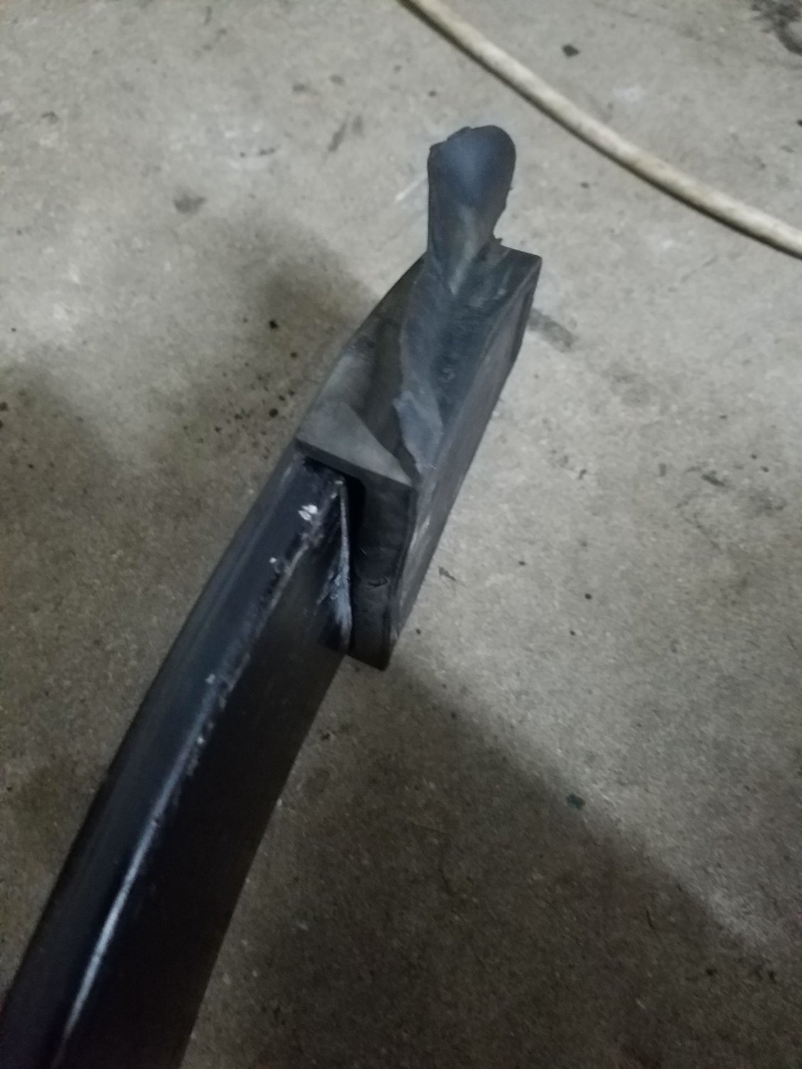

Looking for more advice. I purchased a spring for my C4, but it did not come with the spring pads that go into the lower control arm. I'm looking to remove the old pads from my old spring and epoxy them on to the new spring.
Is there any easier way to remove these pads? I've been going at one of them with a hacksaw and a chisel and really have not gotten far. Is there a way to loosen the factory epoxy?
Also, I was looking to trim these pads down for an additional drop. I've read about people cutting them down, but I'm really not sure how to go about cutting them evenly. How does everyone trim these pads? And is it even worth it to trim the pads? I already have the lowering wedges installed, just worried that the wedges alone won't give me the drop I'm looking for. Any advice would be greatly appreciated. Thank you.

That's kind of what I figured. The end pads were a huge pain to remove, took several hours to get off of the old spring, but I got them off and managed to keep them intact. Heat is definitely your friend when removing them. A friend of mine came up with the idea to make a jig and cut them down using a circular saw, so that's the best option at the moment. Judging just from cutting them off of the old spring, shaving them with a hack saw or Sawzall would be a huge pain as well. Just trying to get rid of my fender gap, don't need to have it dumped on the ground by any means. Would love coils but that's a whole debacle as I have an '86. I'm using the wedges and shaving down the pads, so we'll see how it goes. Did you lower yours? If so, what setup are you running?
