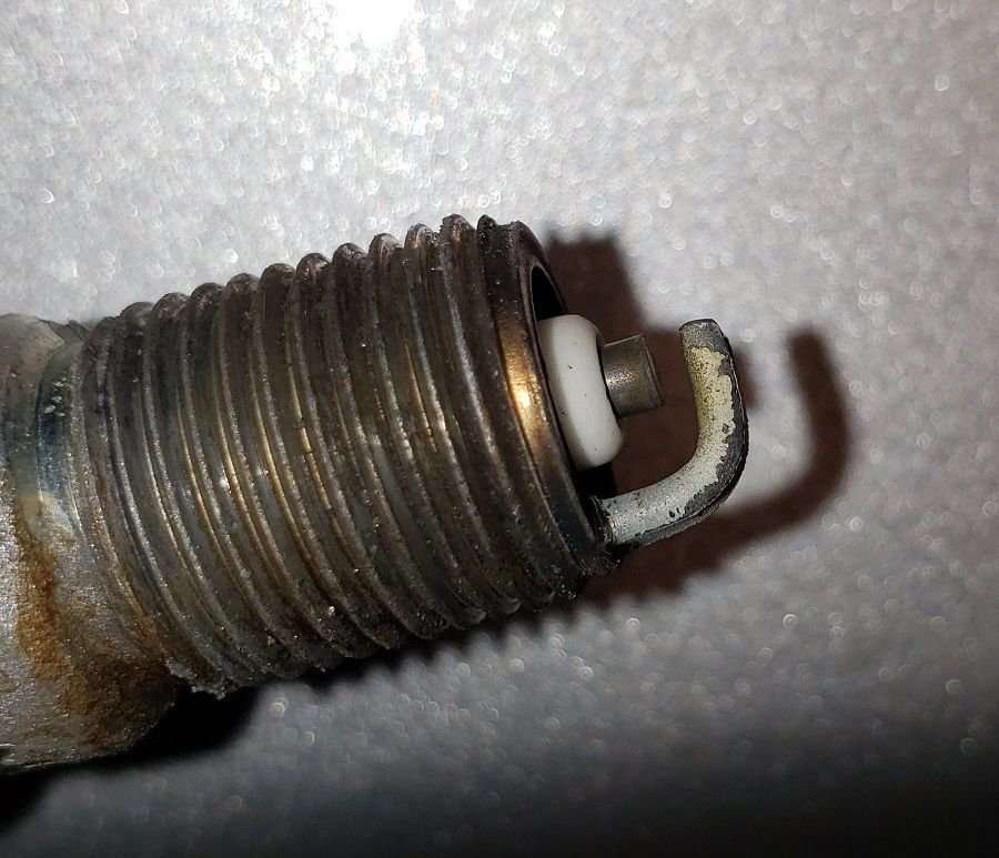

Pulled one plug (because pulling all the plugs is so fun on this car). No oil or carbon... look ok?
