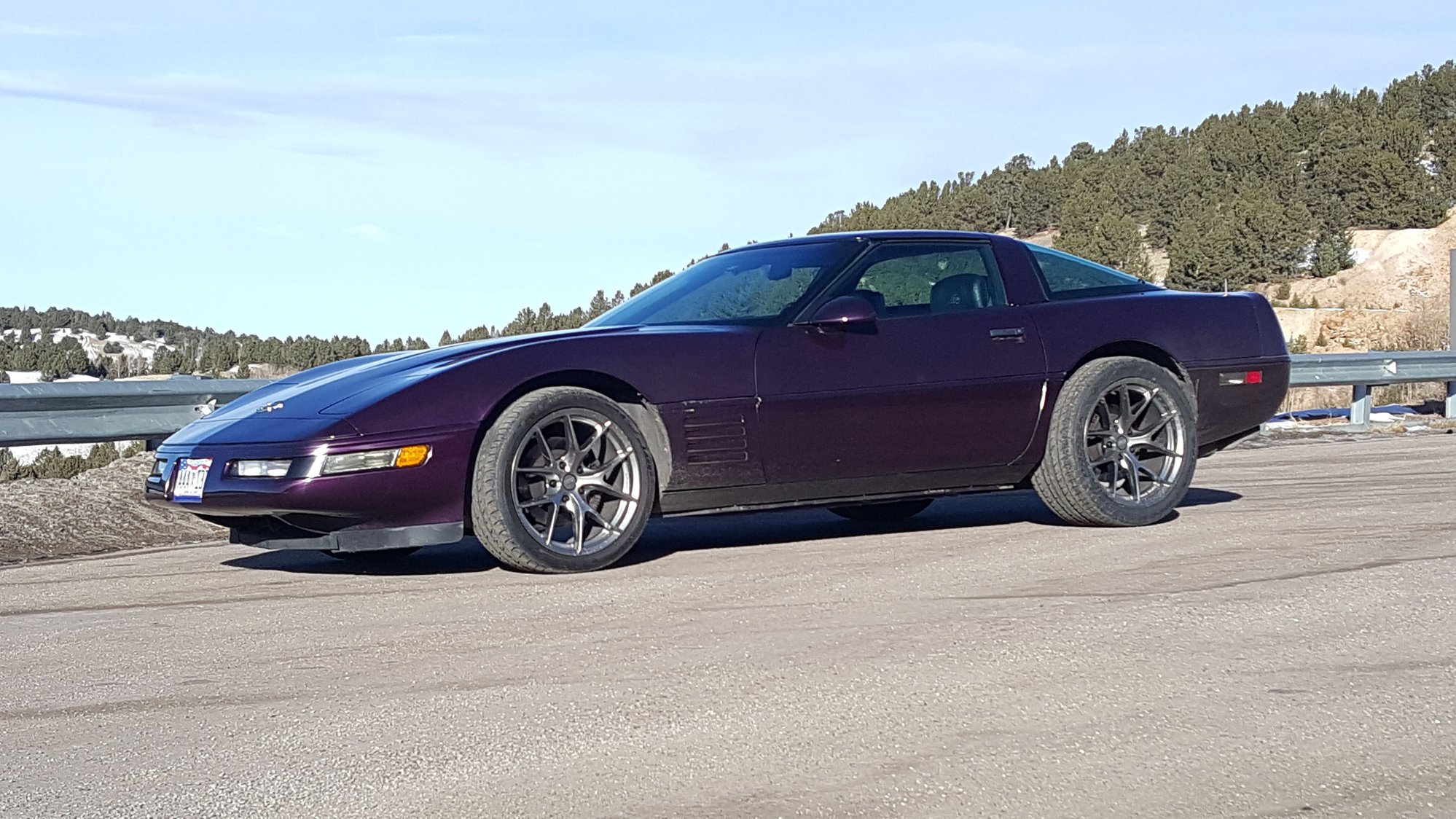

okay 42k on my 93 300hp lt-1 A4 trans dana 36w/ 3:73 gears. Now I'm interested in getting 450hp to be able to keep up with today's Stingrays.
Any suggestions would be helpful. Stop light drags is my thing. I don't want to blow it up. It was my dads car and I'll NEVER sell it.
Turbo vs. Hot cam?
Thanks
