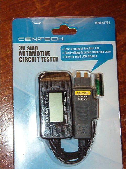

I had a battery drain to locate on my 86. I had the HF tester and used that along with a meter to determine the amount of draw that was happening and where the issue was. To get to the connection lug mentioned earlier, it's under the battery tray so the battery and the tray has to come out to get access to it.
With the HF tester, you pull the fuses in the fuse panel out one at a time and plug the meter into the slot and the fuse into the tester. It shows the amount of current being drawn through the circuit. Remember there are 4 circuit breakers in the front edge of the fuse panel also. You can test those also but you'll have to make some jumpers for that. Remember the interior lights circuit is drawing current when the doors are open, so take that into account.
Checking out the connections on the lug below the battery tray, I disconnected all of them. I hooked the positive battery cable up using a jumper cable to the positive battery (with the battery out of the car) then used a meter between the block and the negative battery post after connecting each of the wires on the lug back one at a time. In my case I found it was something stuck in the well in the console was pressing down on the power seat control continuously. Took care of that and the battery drain was done.
Here's a picture of the meter. Hope that helps. Good luck.
