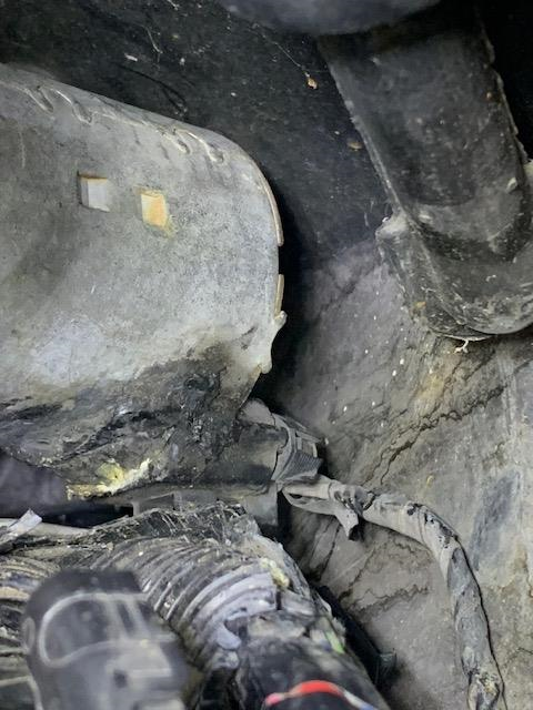

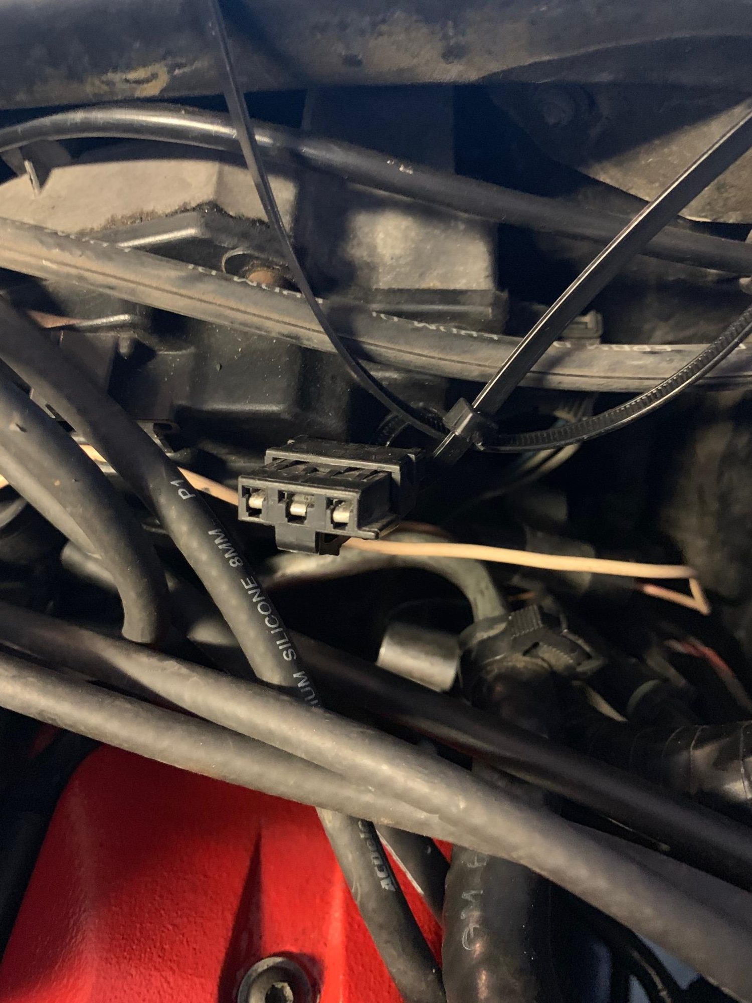

I have a 1990, short story, bought the car with motor out and all parts and bolts thrown in 2 large plastic bins. This being my first corvette, there was a steep learning curve to get it all together.
however its done and I have 2 plugs that were unidentified plugs. I went to start the car 1st plug was quickly identified as the oil temp switch (didn't have it in and it was not in the boxes).
This plug is located near the wiper motor it has a short lead from the main harness so it cant reach far. Maybe I missed it but I think the wiper motor only has 1 plug. Wires are red, black, and brown. I could not find it in the manual

I'm assuming your car doesn't start. That plug should attach to the underside of the coil pack on top of the distributor (drivers side)
Tod got it right. Front wiper connector!

That's the windshield wiper motor connector. The connector is on the front side of the wiper motor.

It certainly appears to be indexed for the cover of the motor. 3 connectors on the wiper motor, end of armature and 2 @ the cover.
OP - the cavity is actually visible in your snapshot! 2d snapshot just to the left of the connector behind plug wire.

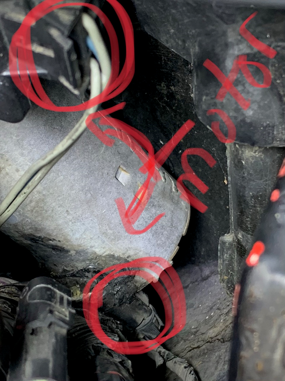

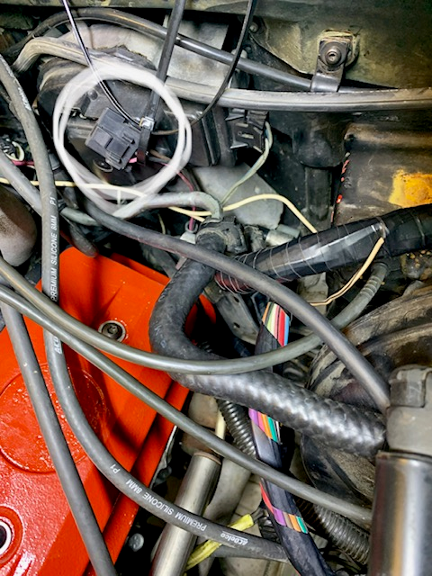

Still unknown wire plug.
- The top of the distributor is plugged into the lower part.
- wiper motor has 2 plugs connected already located in pictures, Maybe I plugged in the wrong plugs??

Your post #5 has the connector and the cavity in the 'white circle'! I'm sure post #6 should have you sorted by now!!
****You did extremely well with snapshots, multiple views, mentioning wire colors etc. Many/most times it's just a very random shot. YOU DID WELL!!!!!

OMG! if it was a snake it would have bit me in the face. Being 6-3 I often look down on things and not at them. so looking down I completely missed the plug on top of the motor. I thank everyone for not calling me a dumbass (thinking it was fine, lol). For my first time on here you guys were great and quick with replies. Thank you!
