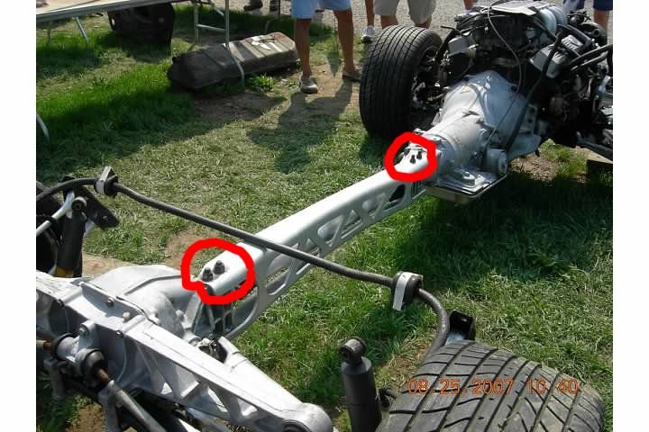

Does anybody have any pics of these locations?
I've circled the two bolts at both ends in the pic below. When you look at the car from the bottom, you'll see the bolt heads at each end of the C-beam. It would literally be impossible to miss them or mis-identify them. They're the only bolts on the C-beam.

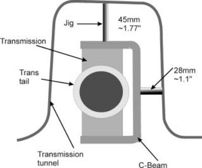

It's important that the 'bores' be round and not worn to be elongated. The nuts are preferred I believe to be 'prevailing torque'. After repeated tightening that you mention I'd say it's time and actually they should have been replaced already maybe. Someone will stop by and likely suggest 'beam-plates'. Might be a good idea.
M12x1.75 (front) and M14x2.0 (rear)
Generally accepted tunnel to C-beam clearance.
