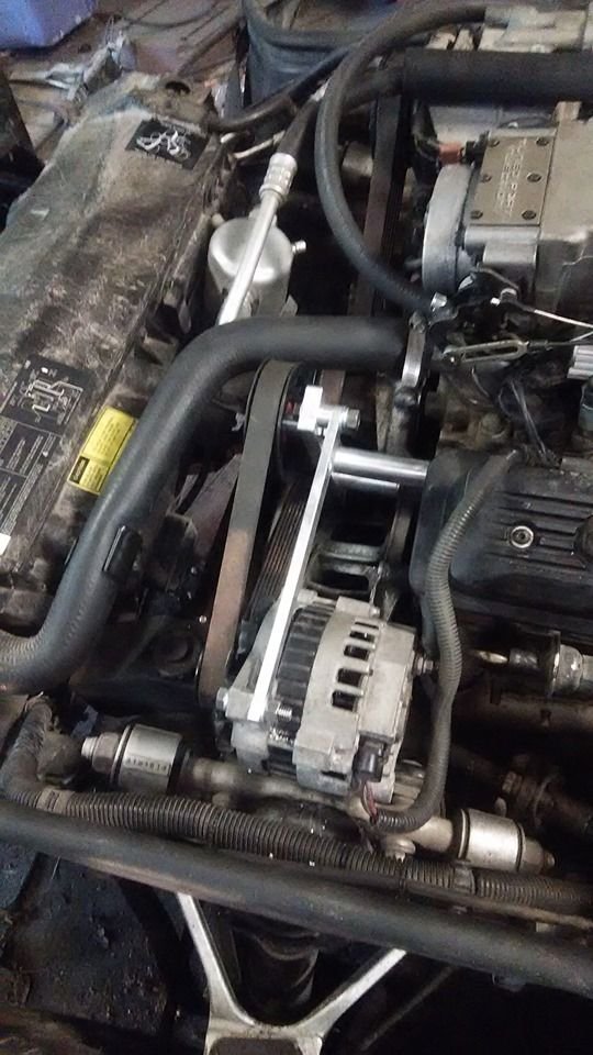

One of the plugs that was hanging, I found that it goes into the lower part of the engine, probably for oil gauge. I dropped off my headers today to have them ceramic and I started pulling my sparkplugs out and the plugs are covered in black soot, I looked it up and it says my motor is out of tune. I started out just needing to fix damage to my bumper and hood and since my brothers 1975 is nearing completion, it just kills me that he will have a faster car than me, I tried to buy back my mustang but the gentelmen already sold it or I wouldnt bother trying to modify my vette. I added a picture of my smog pump delete pulley, and the second photo you can see my fathers 1973 we have finished the frame, sanded, getting ready to put motor and interior.
