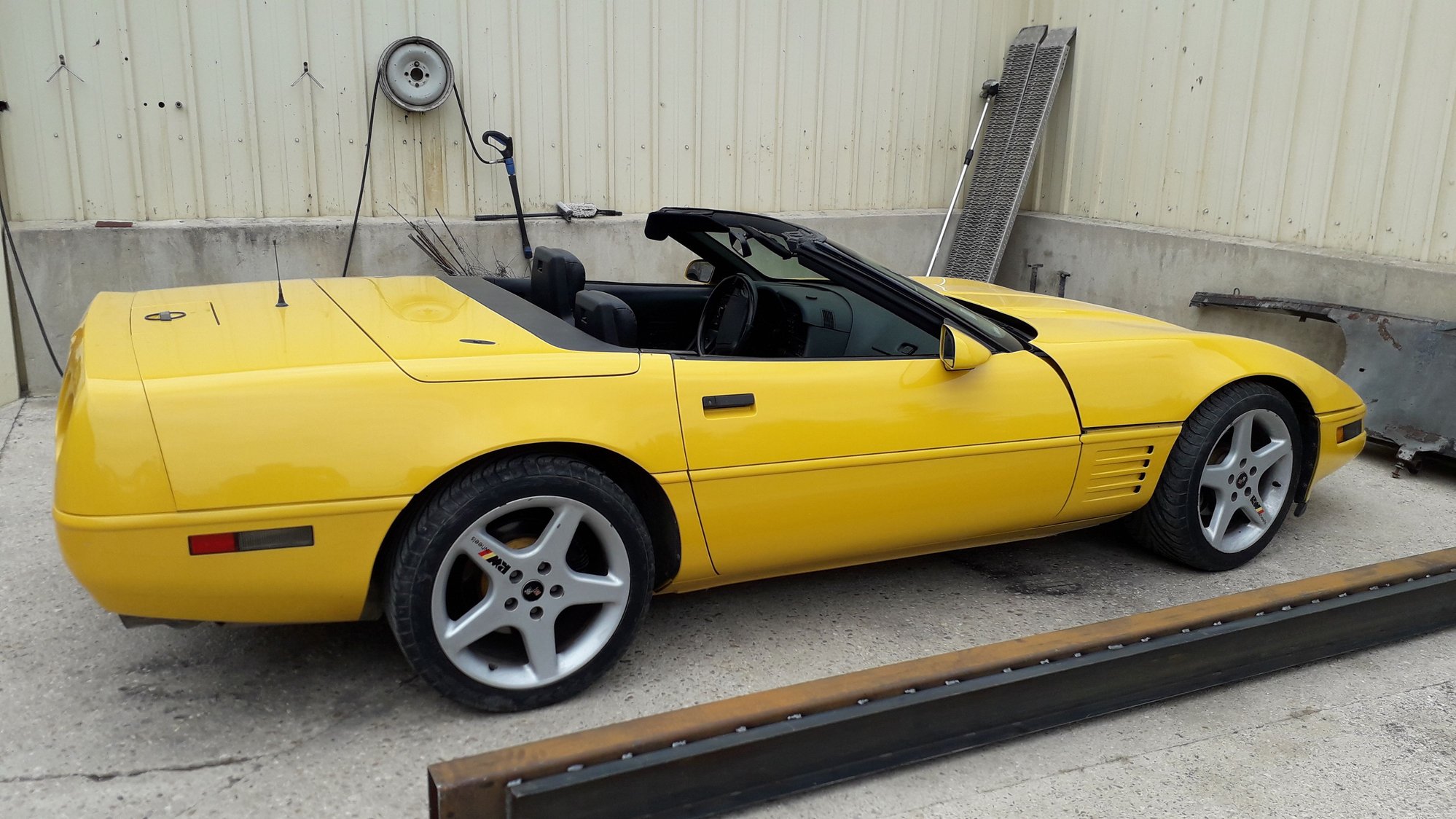

Hello all
I recently bought a 1992 convertible C4 Corvette
she has 76000 miles, and I have not paid too much
it is equipped with wheel and non-OEM tire
295 X 35 X 18
it is also equipped with coil over which I do not know the brand
these coilover apparently have no settings ??
I would like to dismount them to clean them but I do not know how to do ??
If you have any information, thank you very much
Fred

First - those wheels look perfect on that car!
I don't think you need a spring compressor or to separate the ball joint. From what I understand, you can just jack the car up to put the wheels at full droop and remove it as if it were a normal shock absorber, then thread off the lock ring and spring perch using the coil-over wrenches to safely take any tension off the spring.
