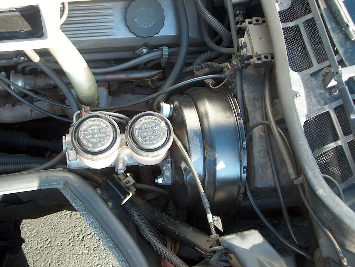

Since you are replacing your power booster, this would be a good time to consider a HUGE improvement in you braking performance by going to a "dual diaphragm" booster from Power Brake Service, Huntington Beach CA: http://powerbrakeservice.net
A little more money, but a big improvement in braking performance! And yes, it's metal:
