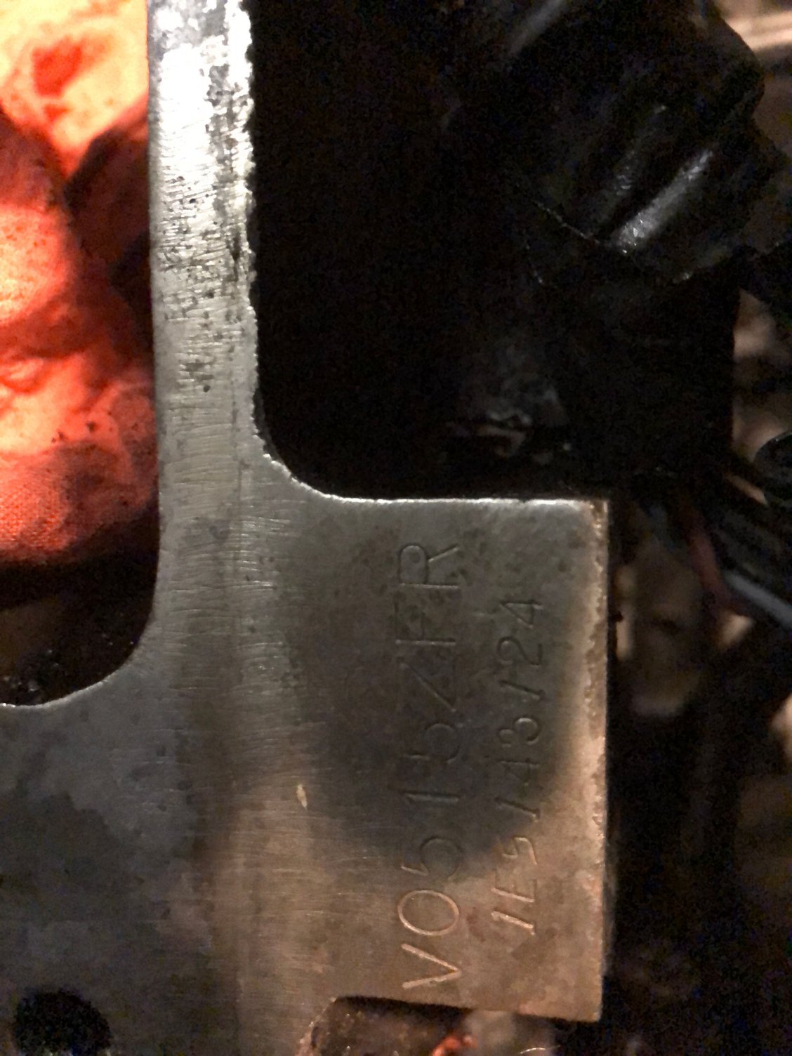

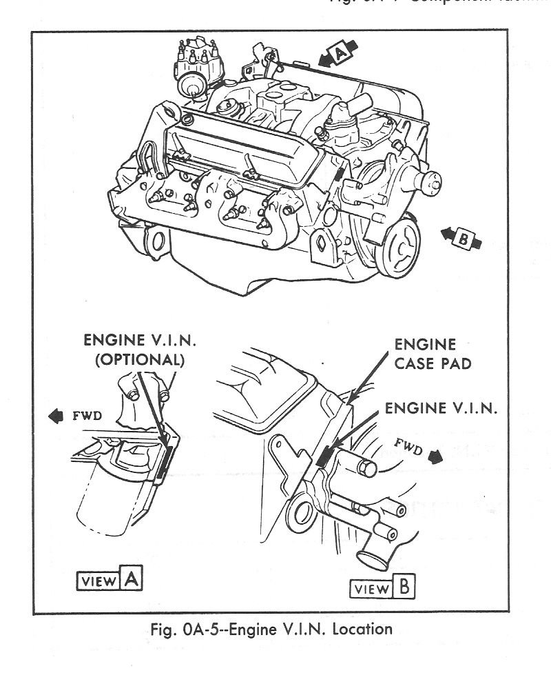

Old Jun 25, 2019 | 06:22 AM
GregMartin's Avatar
GregMartin
Joined: Jun 2018
Posts: 1,402
Likes: 287
From: Brisbane Australia
And this is what it looks like with the heads, intake manifold, water pump, air pump, and AC compressor removed. It’s hard to see with the rotating assemblies installed on the engine but it’s exactly where Roy’s diagram shows it. The last numbers should match your VIN.
