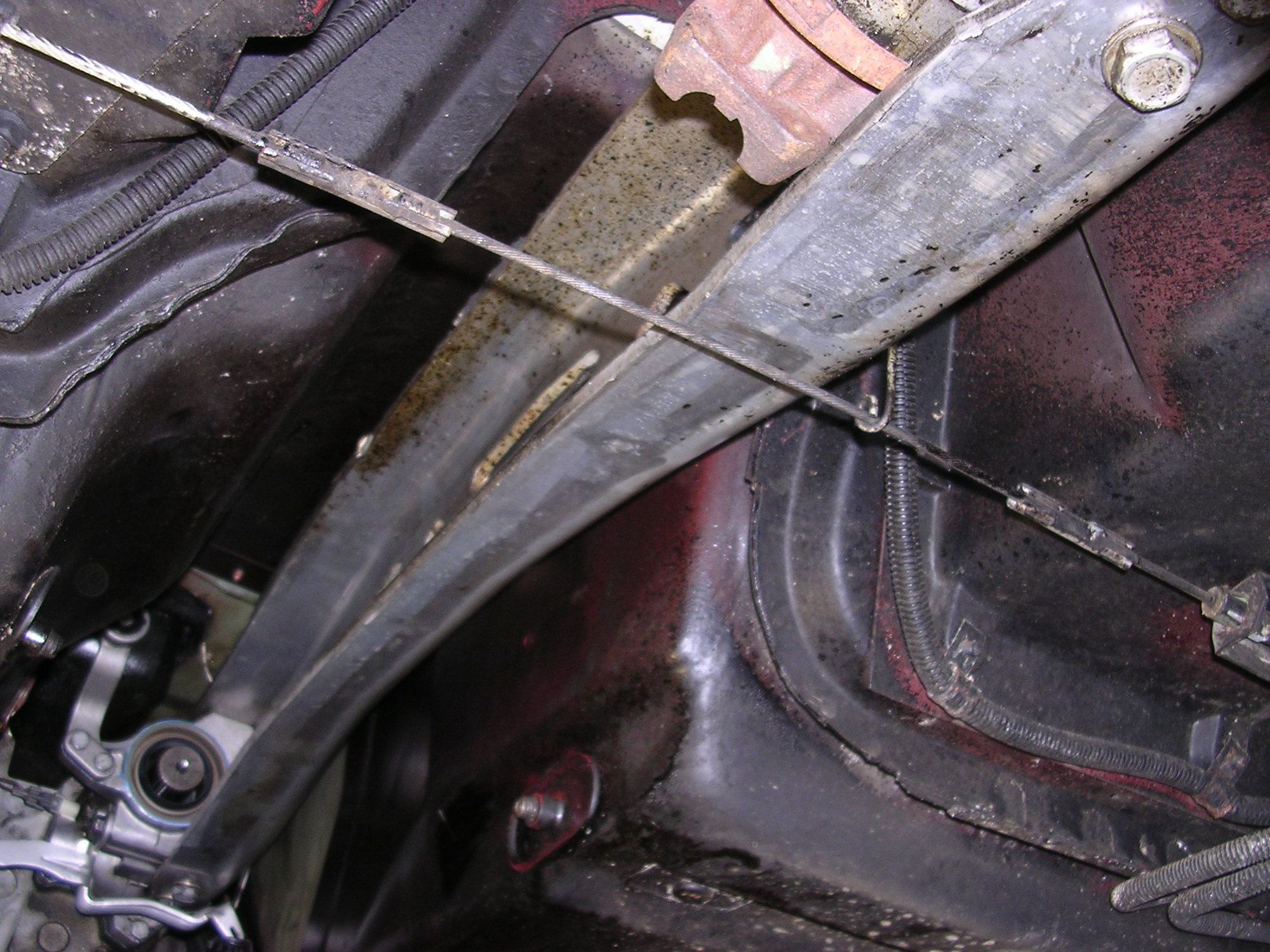

Here's a photo. The bent section is right behind the E-brake cable coupler. This also reminds me that I did not have to move the E-brake cable to get the D/S out.
When they try to remove the driveshaft, it'll become quite obvious where it makes contact. That'll be the place that they'll need to bend the pinch weld. No need to overthink this.

Thanks. I really appreciate the photo. I'll print it out and bring it with me to the shop next week along with the other photo of that weld getting grinded down and let them pick what to do. I see what you are saying on not overthinking it. Which I'm not. The issue is I have to deal with shops who talk skeptically of having to modify the car in order to remove the driveshaft. So bringing visual aids of photos of it should be easier to convince them.
