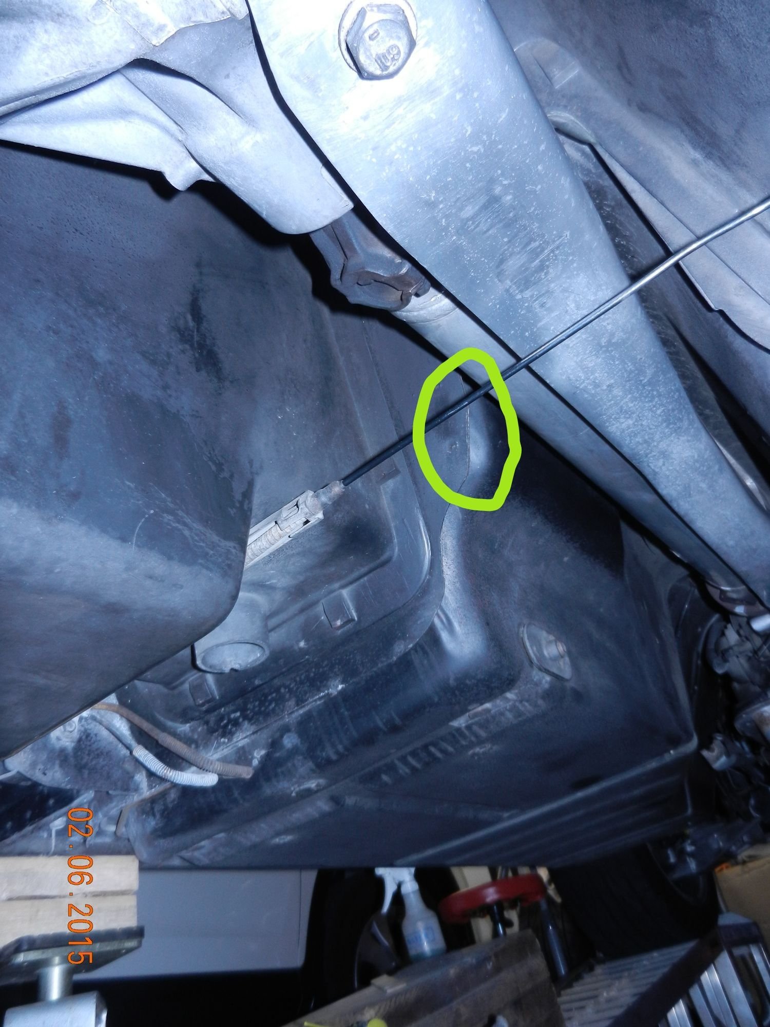

in both cases. did something similar - took a grinder and removed about 1.5" of the pinch weld about 1/8 deep....
here's one of my older post on the subject -
if you are following the FSM, you may or may not know this. if you don't, a little FYI. when you drop the drive shaft, unbolt it at the differential end, and drop it down to the point of interference with the body structure/pinch weld. there's some sheet metal bent and spot welded to form part of the sub-structure. take a grinder and remove about a 1/8" x 1.5" as shown, it removes the interference allowing the shaft removal without removing the support beam. (removal of the support beam is called out in the FSM - ) that is a bunch of extra work. the metal removal is minimal, and no way affects the body integrity -
here's a couple shots of the area I'm talking about...
hope this helps -

If you grind that area down, then you don't need to unbolt or even loosen the bolts on the cross-beam to remove the driveshaft? Is that right?
Is that pinch weld in your pic one that's already been grinded down?
In all the years here, I've never heard of this before. I've only heard that some people were able to remove the driveshaft without having to unbolt the cross-beam and they didn't say anything of modifying the car, but most seemed to have to remove the cross-beam.
The other nice thing if you don't have to unbolt the cross-beam, is that you don't have to worry about the transmission dropping and thus smashing the distributor cap.

From looking at the pictures, I believe that is the parking brake cable or something running under the driveshaft. Does that need to be removed in order to pull the driveshaft? I do plan on grinding that pinch weld so I don't have to mess with the c-beam.
I was looking at getting a grinder wheel that you put in your drill. Don't know how well that will work, but what have others used to grind down that pinch weld? Here's one from Home Depot:

You can simply put a crescent wrench on it and bend it away, and after replacement bend it back.

It will bend towards the drivers side. we are only talking about 1/4 of an inch.

As others have suggested, just bend that pinch weld as required to gain the clearance you need. It won't take much. I can't comment about the E-brake cable, as I had mine torn down way farther, transmission out, etc.
