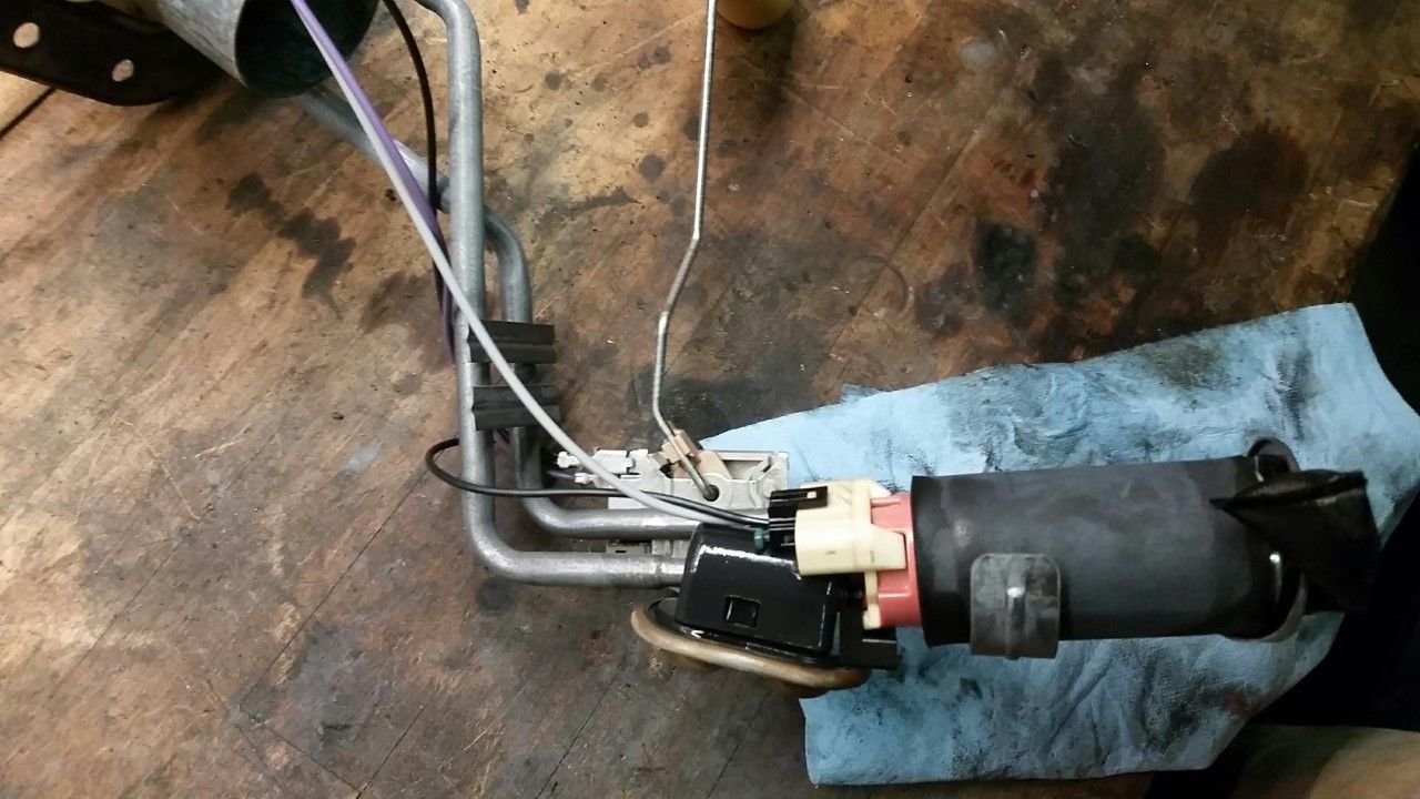

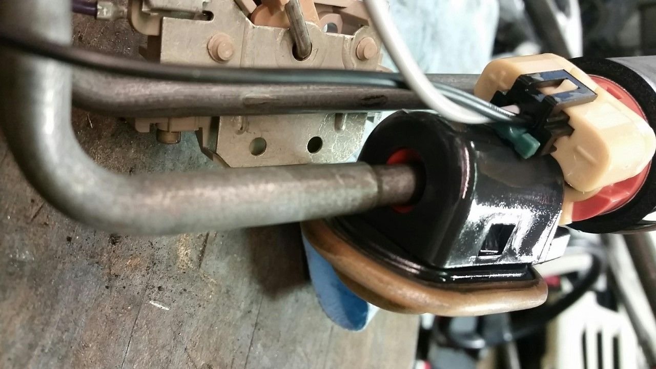

^Not very well. Pressure in the fuel rail should almost always be higher than the pressure in the intake side of the regulator. I think I may have found the problem. Anyone else have issues what what you see below?

Turns out I had the pulsator fail a few weeks ago on a brand new unit. See thread here https://www.corvetteforum.com/forums...r-failure.html
Somehow the symptoms were similar to yours except it didn't start back after sitting.
The consensus is to replace this POS with some submersible fuel hose... I replaced the pump with a new Bosch unit that comes with the proper hose and my fuel pressure now holds well after key off.

I just move the pump back into alignment with the pulsator, straightening everything out, then bent the pump brackets so that they'd hold the pump proper/square with the pulsator. Been running perfect ever since. Oh, I put a new pick up screen on since I was there, but the old one wasn't causing any issues.
