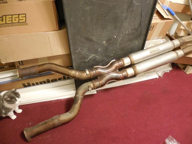

….. I have an X on mine … on a C4 , positioning is determined by the transmission and the tunnel … 3" pipes , Summit bullets , and 50 series Flowmasters … great sound , NO drone … and they run 6.7's @ 100+ in the eighth …..

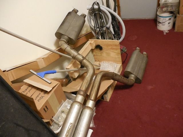

Im going to take a photo of how mine is laid out today, and post it on this thread.

I run a custom x-pipe my muffler guy fabbed up for me, installed in place of the factory resonator. With a stainless chambered exhaust, it's VERY quiet at idle but loud enough to frighten my wife (driving in front of me) when I get on it. No idea if it makes any more power, but it's significantly lighter than the piece it replaced.

….. I bought a used Stainless Steel 3" B&B system for LT1 cars minus the resonator … the B&B mufflers were on the car for about 2 days and droned so bad that I couldn't drive the car … at one point , the car was idling in the driveway with the garage door open (attached garage) … I went into the house to get my sunglasses and the cupboard doors in the kitchen were all vibrating and making the strangest noises … I drove straight to the muffler shop that installed the mess and had 'em put the Flowmasters on … What a relief ! ….. The X was an E-Bay purchase …..
