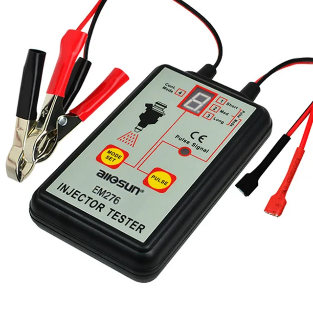

For future reference, this an example of what I was referring to:
You hook this up to one injector at a time, bring up fuel pressure, pulse the injector once, and note the drop in pressure. There is a procedure for testing them outlined in the FSM. The noid light just verifies that the injector is getting a pulse, this tool actually fires the injector and lets fuel through.
