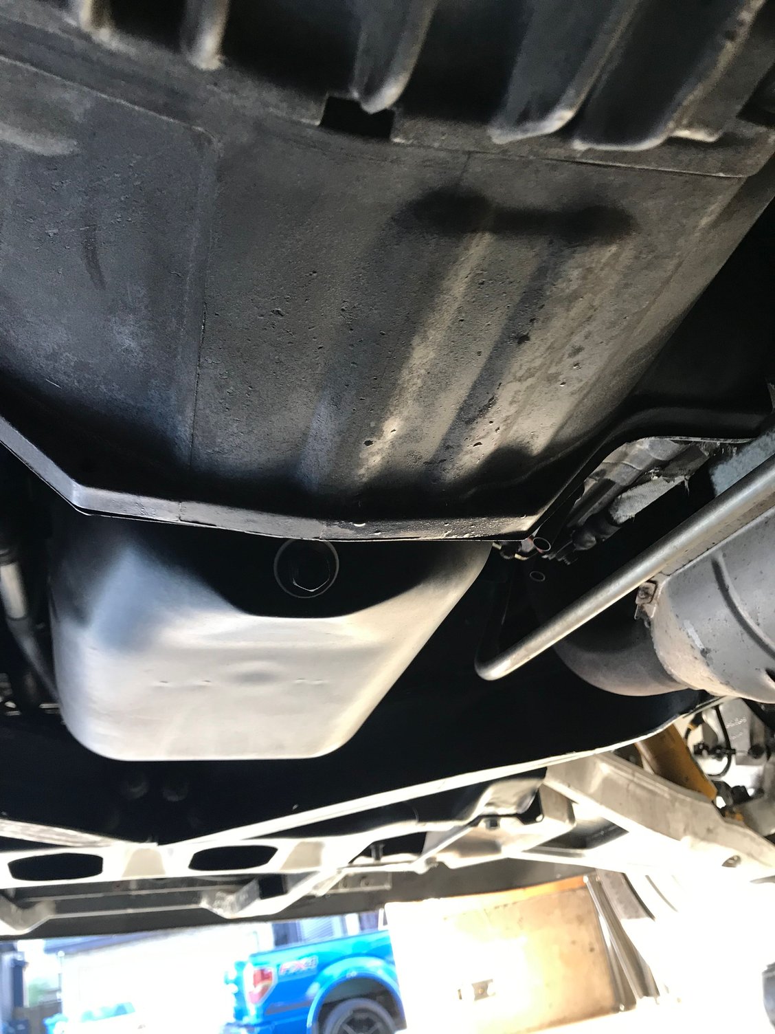

I didn’t look up around the pedals yet, but I had the car in the air and I think I found evidence of the slave leaking. The drips you see in the pics (might be a bit hard to tell) were almost unnoticeable at first, but I think it’s Dot 3 fluid. My thinking is it’s leaking into the bell housing and traveling down to the lowest point where it’s dripping out. Sound reasonable or could this be something else like a rear main?

Yes, it could be the rear main. Let’s hope it’s not. But that’s why I said removing the slave from its mounting
is the best way to determine if the slave is leaking.
It can be difficult to tell what’s leaking or not if the main is bad. Sure, there will be oil, but you also get the road dirt,
Dot3, and maybe even condensation from the heating and cooling of the bell housing.

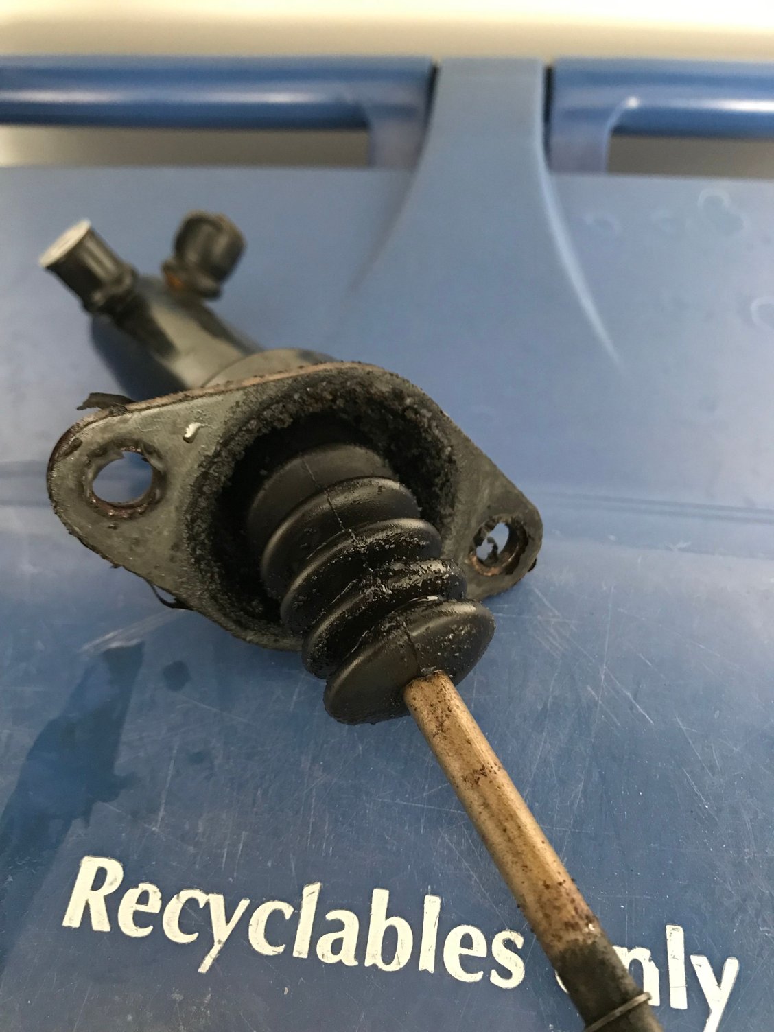

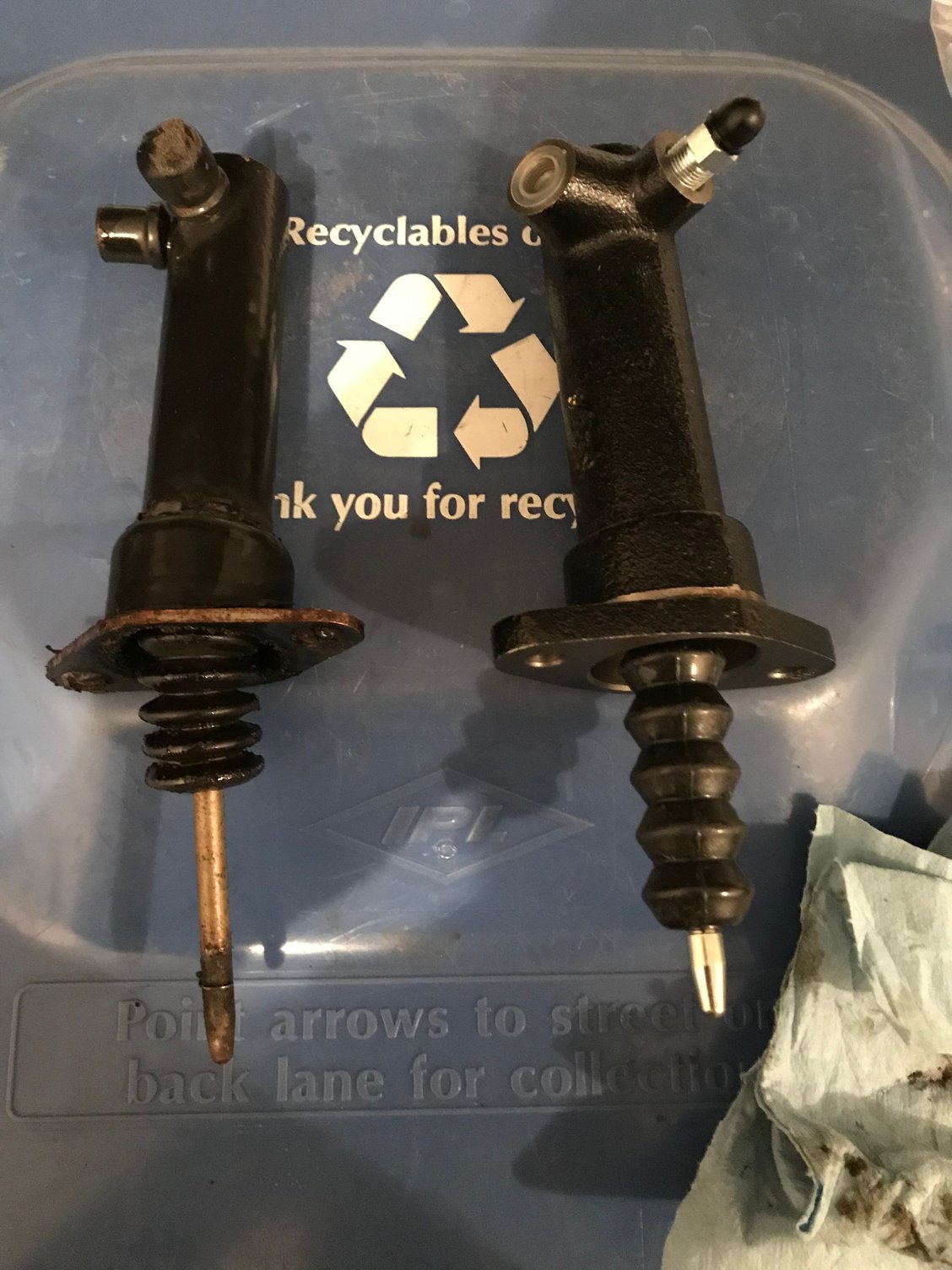

Well i'd say it was a successful day. Other than it being a little awkward and a little cramped around the salve cylinder, the job went fairly smooth. I didn't end up reverse bleeding the system, I simply bench bled the slave, which I think resulted in almost no air in there, so really all I lost was a bit of fluid from the line coming down and a little as I threaded the fitting onto the new slave. I topped off the fluid and had my pedal back in less than 40 pumps i'd say. I continued to do it more just to ensure no air was coming out and even recorded with my iPhone, so I think I'm good. I put 25 or so trouble free miles on the car afterwards as well.
Here are a couple pics of the old slave and of course the new one. Without a doubt it was leaking...
I appreciate the help everyone!
