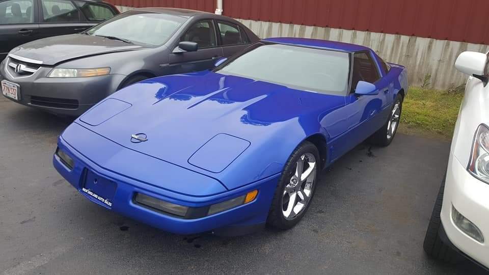

Looking for someone ĺdoesn't have to be a shop) who can work on my 95 Corvette in the San Antonio area. Just broke 100k and now looking to get a significant amount of hp out of the current engine.

awesome color!
