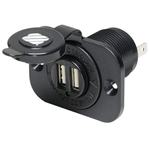

Mine in my 89 also didn't work...but I didn't need it. I found a dual port USB charger and installed it in place of the cigarette lighter.

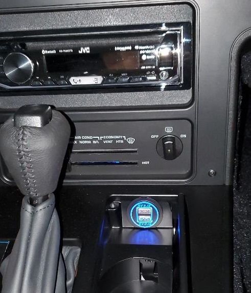

Those lighters short out stupid easy. The plug on the back either fell off or the PO took it off as it kept popping fuses. It's just two wires that connect to the main harness next to the radio so not super complicated to replace if you wanted to.
Do you smoke? If not, assumption is you want the cigarette lighter to power something or charge your phone. In that case, get one of these. Super easy to install. Just have to expand the hole a tad. I just installed mine into the factory ground wire from the lighter and the power line going to it.

That is exactly what I did. If memory serves the original hole was about 25mm(1") and the USB assembly was 30mm diameter. I opened the cigarette lighter hole accordingly. Connected it up as did 85WHITEZ51.

Yeah, the one I got was 29mm. Used a sanding disc on my dremil and opened it up just a little bit and had to shave the bottom of the USB port cover flat. Fits nicely and powers 2 devices now.

What is the part youre using in place of the lighter socket? Is it a universal fit or are you rewiring and soldering the connectors to the factory?

I used this USB socket. Has spade lugs on the back end. I took off the flat panel and cap thing and mounted it after opening the cigarette
lighter socket hole. I had to make a small flat on the face edge too. Not as fancy as 85WHITEZ51's but it works okay.

That is the one I have. Just a FYI that the backlight stays on all the time. It's not seen with the cover closed but if you store your car for long periods of time without a trickle charger it will drain the battery. I keep my car on a maintainer since it's not a DD but you could easily attach it to a switched 12v source instead of the factory source which is constant. Just wanted to give this heads up in case you connected to the factory power source.

And you just butt-spliced their connector to the factory hot/ground wire, how much did you have to open the hole with a dremel?

I actually cut the factory wire and solder in the new connectors. I want to say I had to open it up about 6mm or so. No modifications needed to the sub assembly, it was just the center console plate. The charger is plastic so trimming it was easy as well with a cutoff wheel on the dremel. That was necessary so it would sit in there nicely. Overall it was a fairly easy install/mod.
Another way to install would be to just connect directly to the battery if someone didn't want to make any modifications to the factory harness.
