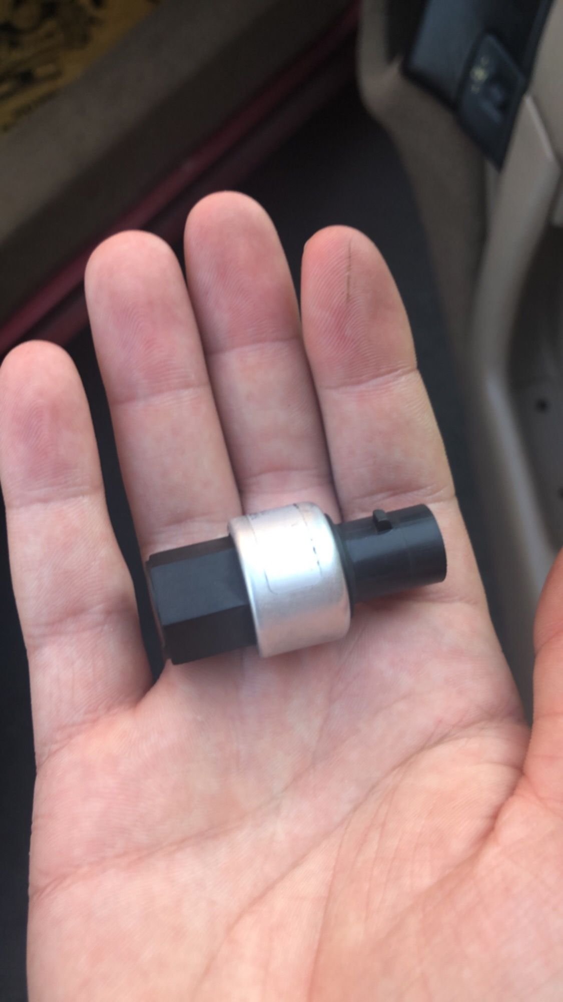

I cannot for the life of me find the Low Pressure A/C switch that will fit this car. I bought one from advance auto but it would not thread on it looked identical to my old one. I’m almost certain my original one is bad. Could someone link me to the Low pressure switch that will fit a 1992?

None of the ones on rock auto really match up with what I have in the car now. 2 wire setup. My mechanic was scratching his head. The GM part number is 52461142.

Aha, that makes finding it MUCH easier...and inexpensive ($6.29) too! Here you go ---> AC Clutch Switch

So, the 92 with R12 cycles at 25psi. The R134 systems cycle at 22.5 psi (switch). I can't say for sure if the threads on your evaporator for the switch is the same on your 92 and is on my 94. I don’t know if you can screw a 134 switch on to your 92 where there was a R12 switch. (One would think so but maybe not).
However I can give you part numbers that are for a 134 system (94-96 vette) that can be bought at any local part store. One is the Santech MT0205 and other, 36659.
You should monitor either thru a voltage or data stream the output of the high pressure sensor on the high side. If the voltages are not correct, the ECM will shut down the compressor.
Also the cycling time of the compressor is measured by the AC programmer and if the rate of frequency of cycling is not correct it can inhibit the compressor.

Thank you I think that is the part I need. I bought a Delco part from Advance auto that said it would fit a 1994 corvette (R134) but it would not thread into my 1992. But last night I unscrewed the factory switch, and it had gunk in it. I cleaned it out and dried it, I put it back on, seems to work without shutting down the compressor now. Fingers crossed.
