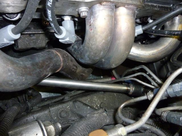

Anyone run strait plug heads on L98 without having spark plug clearance issues on headers?

I'm running straight plug heads and ARH headers. Absolutely no clearance problems.

Heddman's cheap steel ones will have interference issues. Fixed it on my friends '91 with a hammer and a socket with a little heat. No experience with higher end units.

I don't have issues on my headers but there are many brands out there. Some you have to bang it up to comply, some you don't. How cheap is your header?

I currently have Dart 180cc angled plug heads and there a real pain on the passenger side to change plugs.
I have some decent decent generic aftermarket heads that are straight plug with similar flow numbers to my darts.
I just didn't want to make the swap if they still have interference problems.

For easy access to RS plugs remove the rear plastic inner wheel house (5 min) then use an extension & swivel plug socket.
