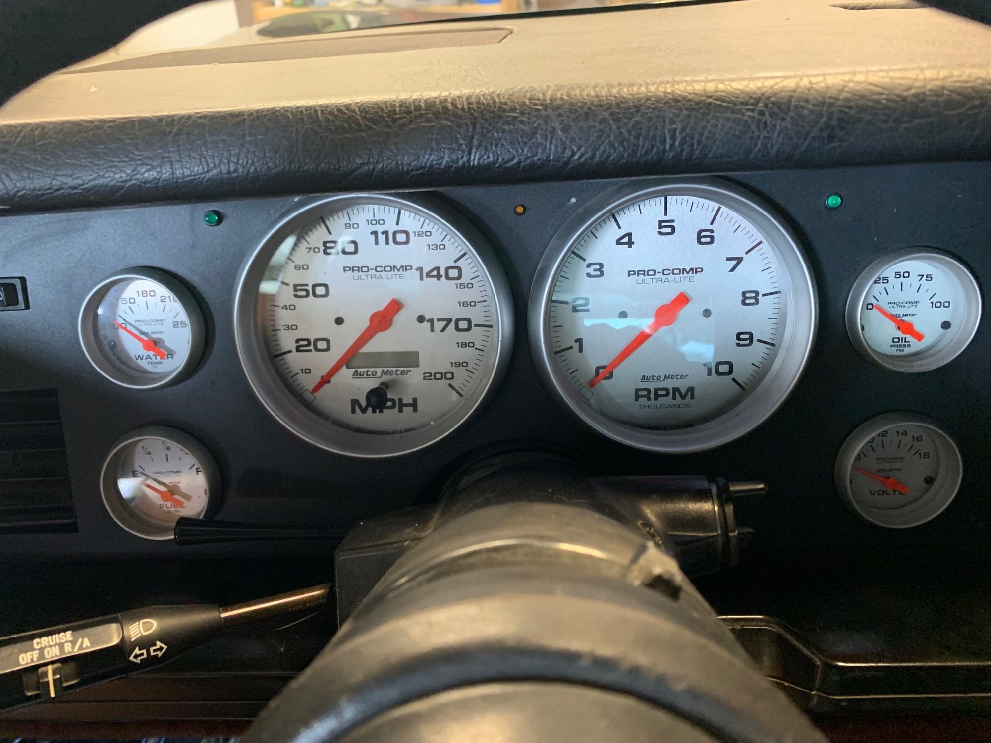

I installed a set of autometer pro comp gauges in my 86. I bought the panel from vettaid. It is plug and play, no rewiring necessary. You can try to save a few bucks by making your own panel and wiring it all together but it's not worth the trouble. You can just unplug the information center and toss it. No rewiring necessary.
