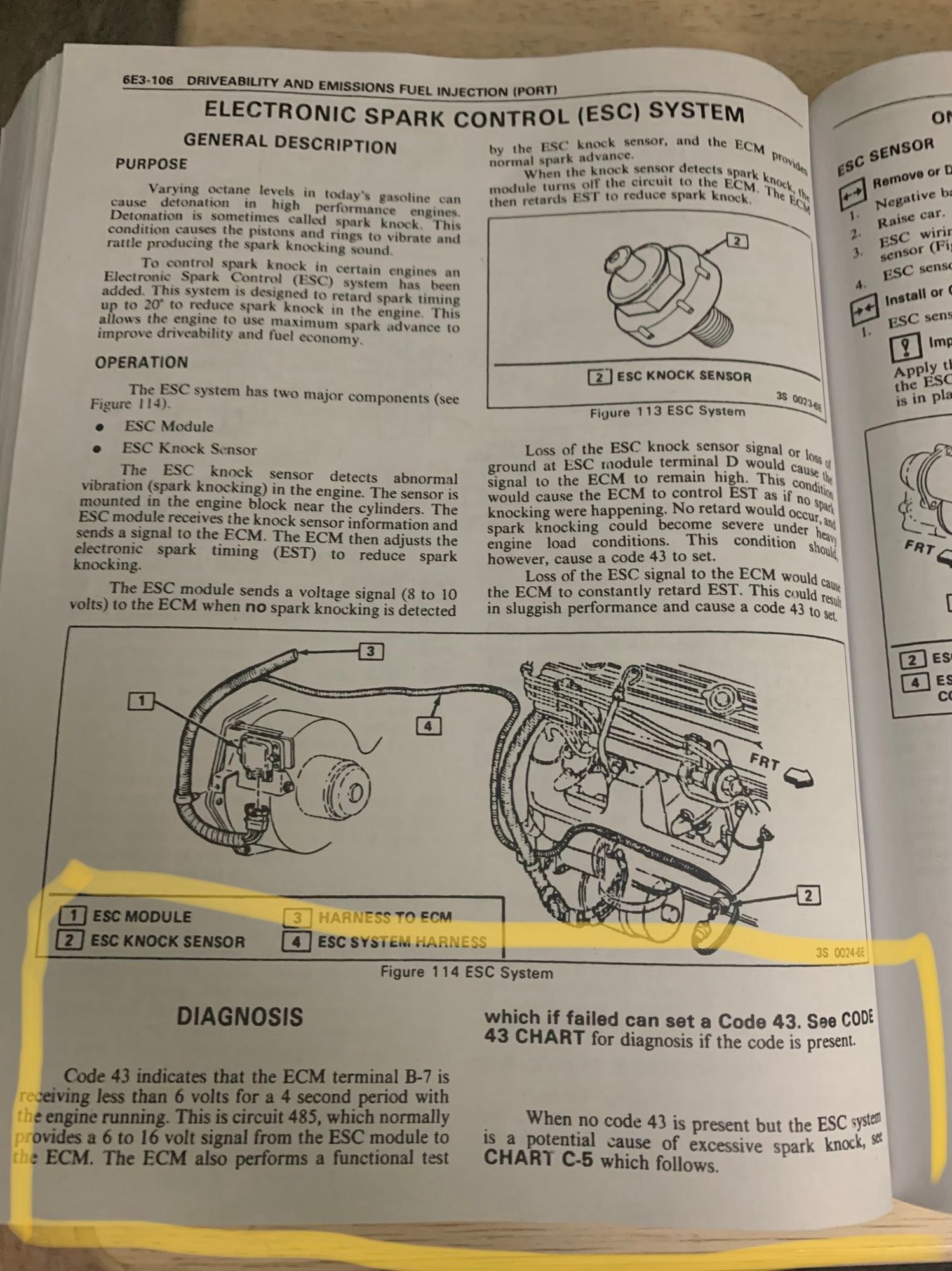

Hot Rod, are you able to confirm that if somehow my distributor was turned enough and in fact retarded the timing the engine will not knock? Haven’t received my timing light yet. Ordered online and I’m in Florida battling a hurricane right now. Below picture is exactly what I am experiencing. I am FAILING the performance test where the ecm looks for spark knock. How would my engine timing get so retarded? Can this happen on its own? What other reasons would cause a NO knock situation? A reminder, I am able to drop RPMs when I tap on the block. So the circuit/sensor are working.

Well I officially feel like an idiot...
timing was waaay retarded. Not sure how I didn’t catch this. It’s my first gas engine (I’m coming from a diesel background)
I wanted to update the thread..
timing is set, new rapid fire plugs, wires, dist cap, rotor, coil, and icm. TPS set properly. She RIPS now.. can burn the rears with ease.
The silver lining in all this I guess is, I researched SO much chasing this code that I learned A LOT about HEI, EFI, EST, ESC, knock sensors, pinging, octane, SBCs and corvettes in general. I look forward to continue using this forum!! Thanks to all!!!
