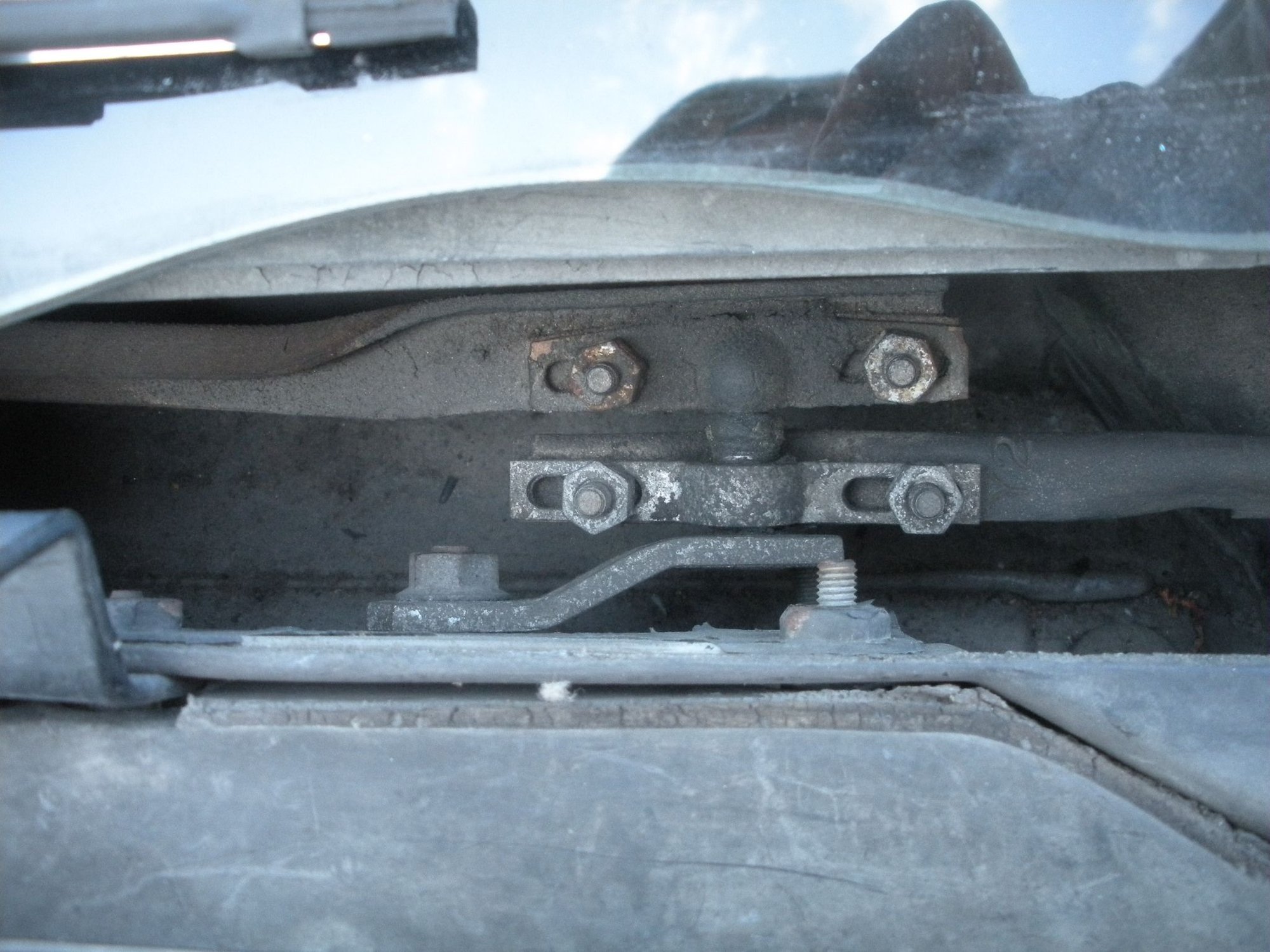

Here's what the adjustments look like, under the screen at the base of your windshield:

Thank You, Gentlemen, got them working again.
