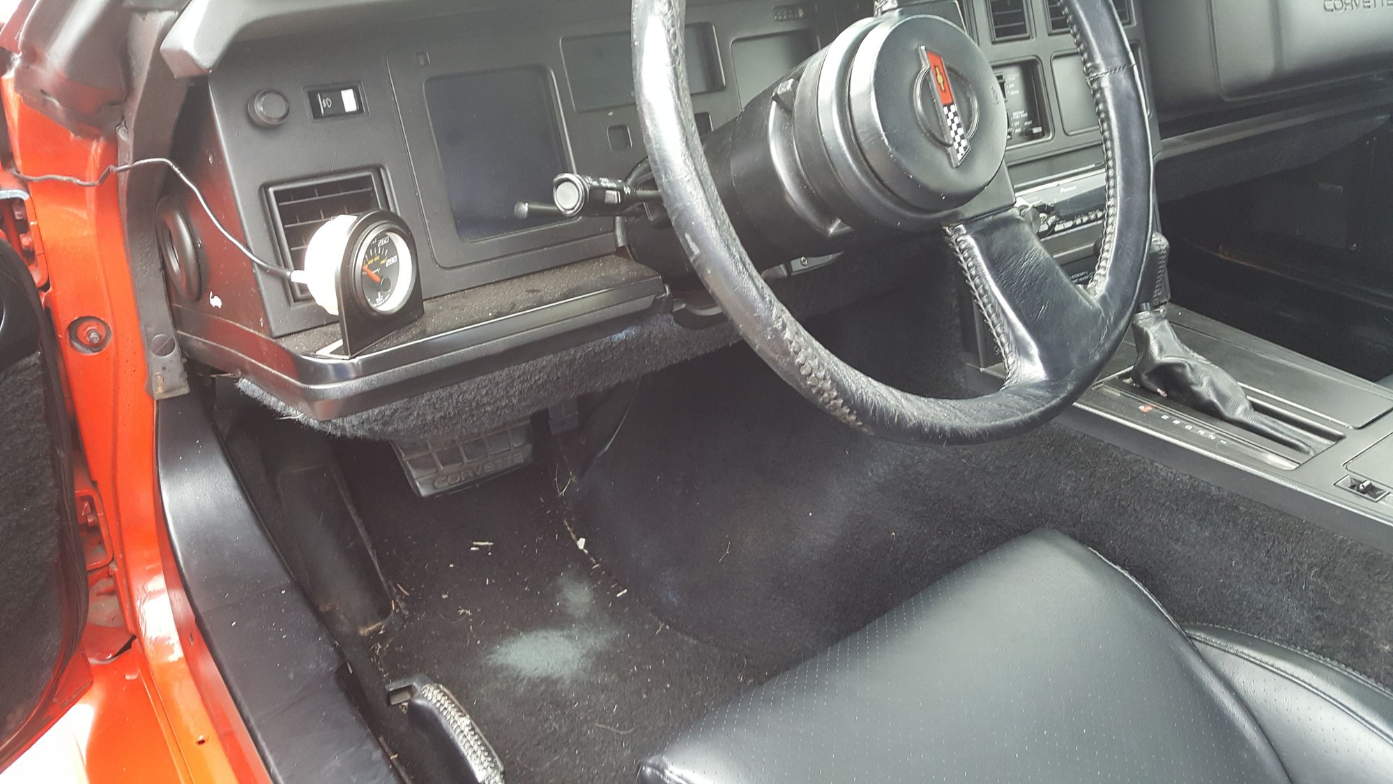

As asked here are more pictures

pretty clean car...
I always ran 87 unleaded, (10% ethanol) during the summer, let in run low in the fall, and then fill it with 92 octane premium containing no ethanol, for over the winter storage.
I doubt that choice of gas is causing your idle speed issues, but stay will the premium for awhile , and see if it stays good. Put some miles on that car...
