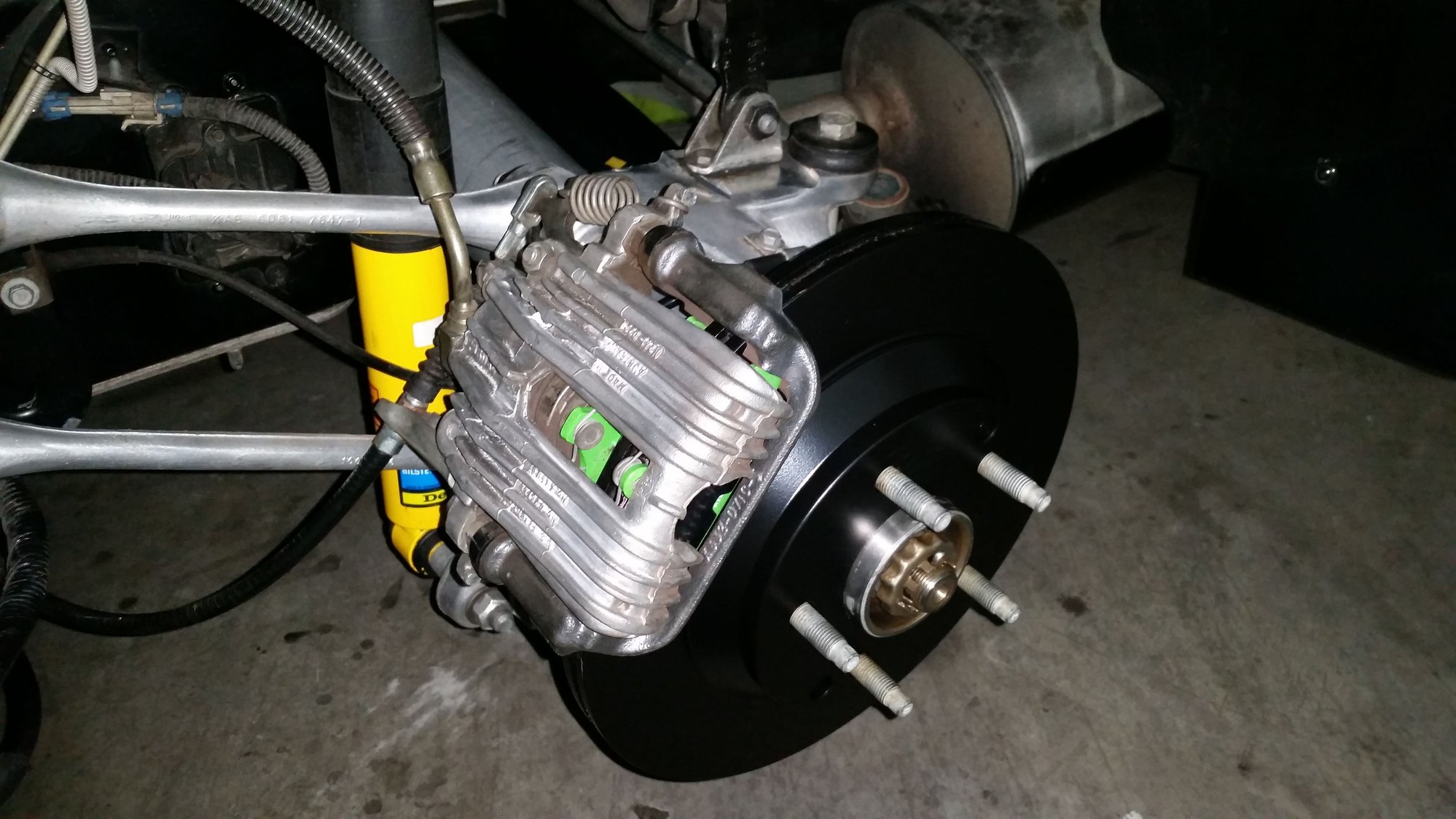

I agree, but this car
was never driven in the rain and kept in a heated garage. But if it does need wheel bearings she'll get the Timken for sure.
Nice, really, really, nice

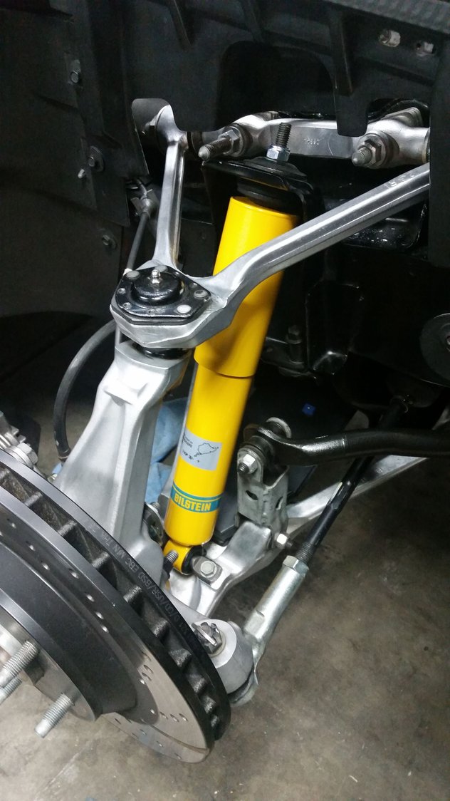

Originally Posted by compyelc4
"Never driven in the rain"? If you drove it at all, how did you avoid that?! On interstate travel I have hit many pop-up showers, but I never intentionally took her out if it threatened rain, but over the years I learned that rain does not hurt the C4 at all, and the underside of my very babied C4 looks like yours. Nice job with the silver painting. Makes her look real clean. Mine has not seen a paint can however as I prefer alum polish to a high luster and a lot of elbow grease.
Silver paint? Maybe you should use eye glasses, who the heck would paint aluminum!
I guess you think I painted these too
