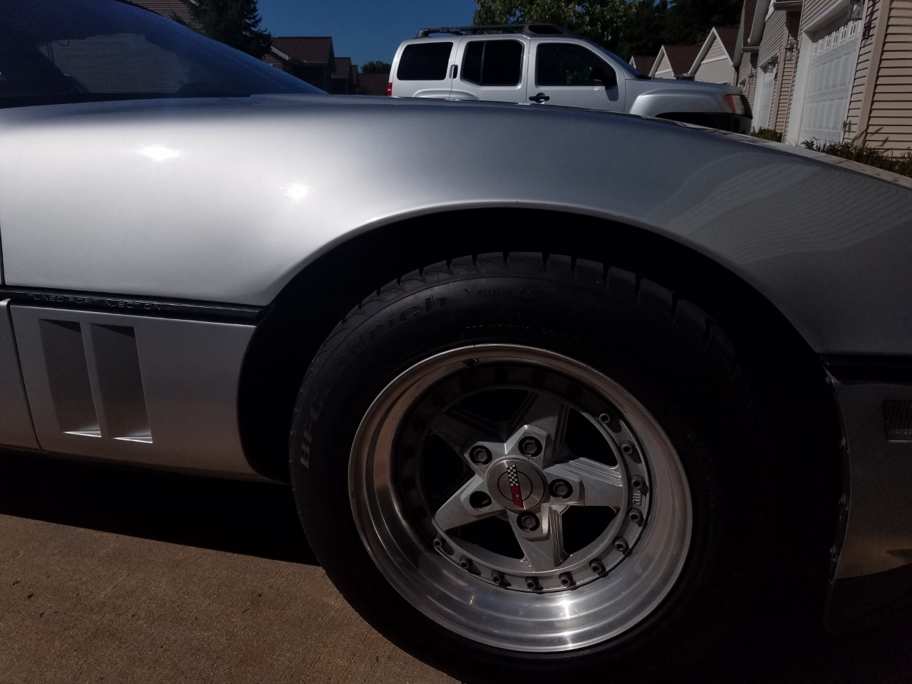

Hello all,
I am wondering if any of you could offer me any suggestions. I posted here a while back about my car not going much lower than stock height after shaving the spring pads down and shaving the spring end pads down as well. I recently took the spring out again, and besides just using the shaved down factory pads, this time I shaved all of the rubber off of the top of the spring and installed the lowering wedges from Mid America Motorworks. I used JB MarineWeld and glued them to the frame where the retainers sit, as I could not get all of the rubber residue off of the spring itself. Well, I put it all back together, and the car STILL does not sit any lower. I have driven the car about 300 miles since taking everything apart and the height has not changed at all. Can anyone offer any advice to rectify this??? I really want my car to be lower than stock height in the front, and after doing this twice, I'm fairly irritated.
The car is a 1986 with a 1984 Z51 Front spring. As previously stated, I am using the MAM lowering wedges, shaved down spring end pads, modified '88-'96 aluminum retainers, and no shims between the retainer and the frame. I also did not have to take off either of the lower control arms, so that should not be an issue. Any help would be greatly appreciated, as I would really like to rectify this situation. Thanks!!

Thanks for the reply. Sorry I didn't reply earlier.
My bushings don't look horrible, maybe a little bit of cracking but not completely shot. Still think that could be the issue? I'm out of ideas honestly.
Yes, the rear of the car is lowered. It is currently not as low as it could be due to the fact that I want it to match the front. Bushings don't look terrible in the rear either.
