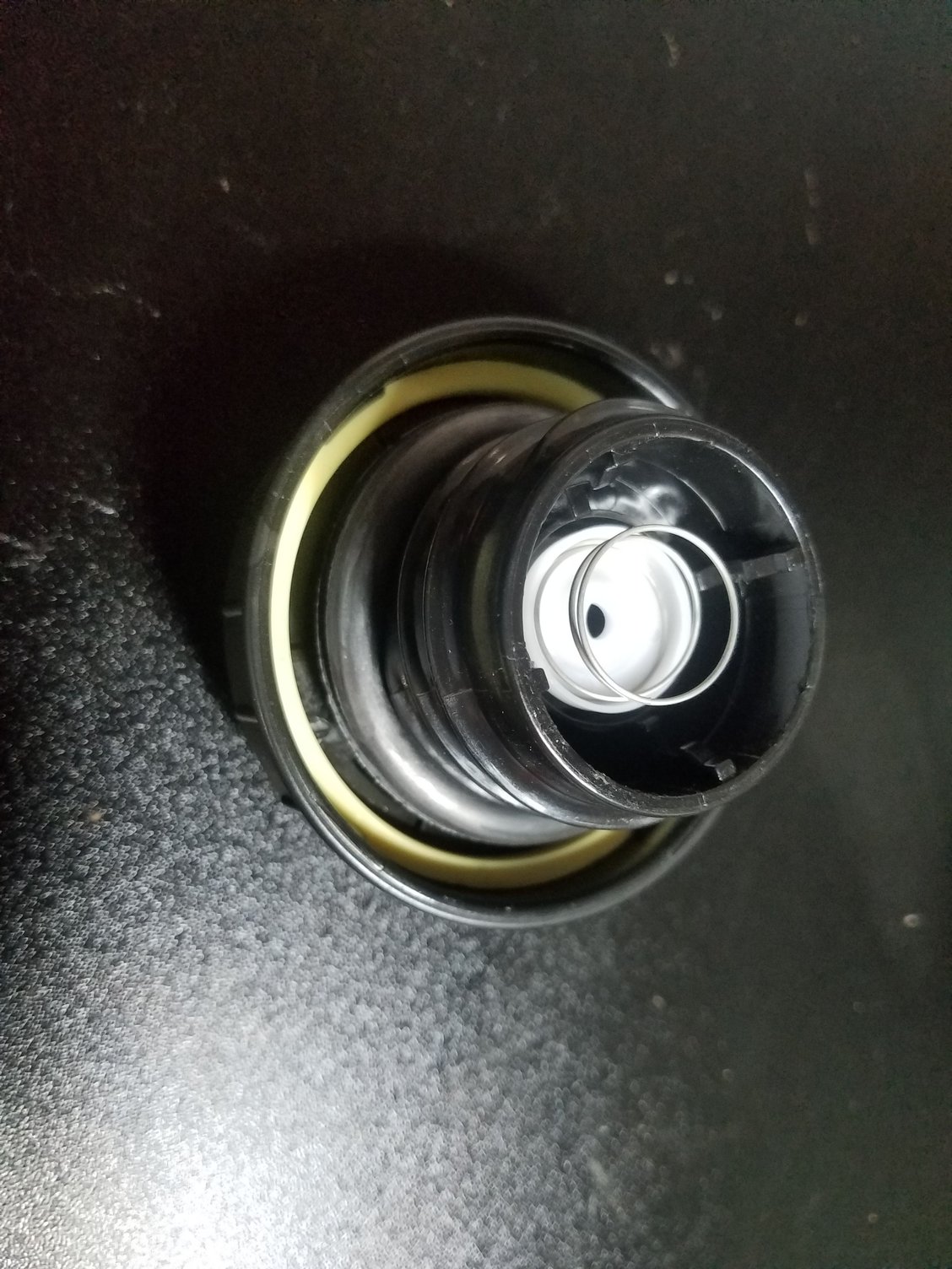

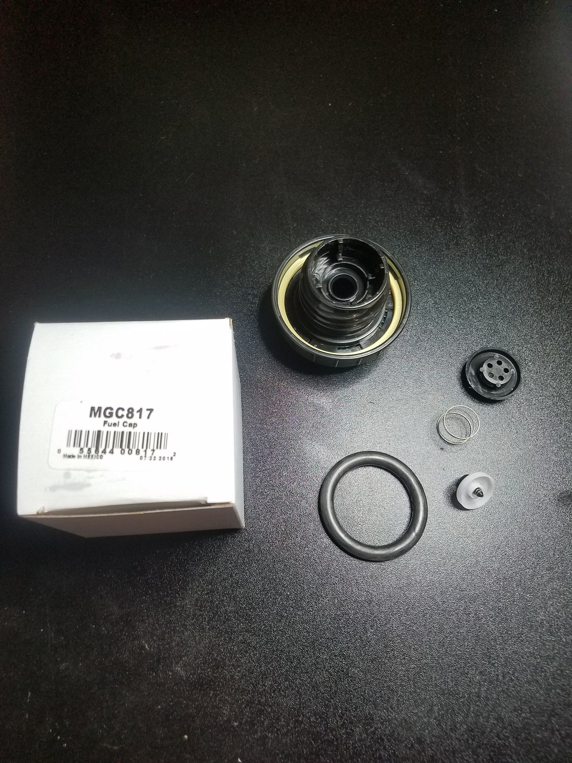

This is a standard $9, aftermarket replacement gas cap available virtually anywhere, shown disassembled. It actually is vented (even though peeps will claim it's not...), it just isn't vented straight to atmosphere like the old days. In the cap there are two valves, a black tiny poppet valve and a larger white valve the poppet valve seats in.
1. If the pressure inside the tank is high, the black poppet valve opens and vents the excess pressure to atmosphere.
2. If the pressure inside the tank is low, the white valve opens and atmosphere enters the tank.

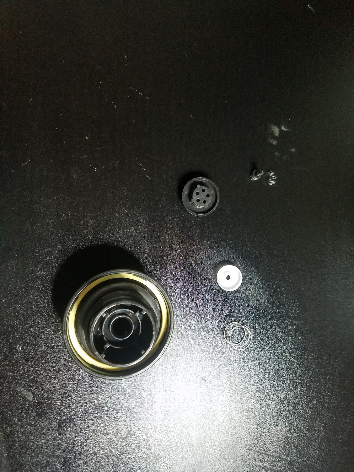

So, there are two ways to approach this... either modify the black poppet valve spring or remove the black poppet valve entirely. I got rid of it entirely. If you are worried about you getting in an accident and your car rolling over and gas leaking out and igniting and BBQ'ing you DON'T DO THIS MOD AT ALL:
Now to reassemble:
Now that that's done, install it and keep your old gas cap, just in case.

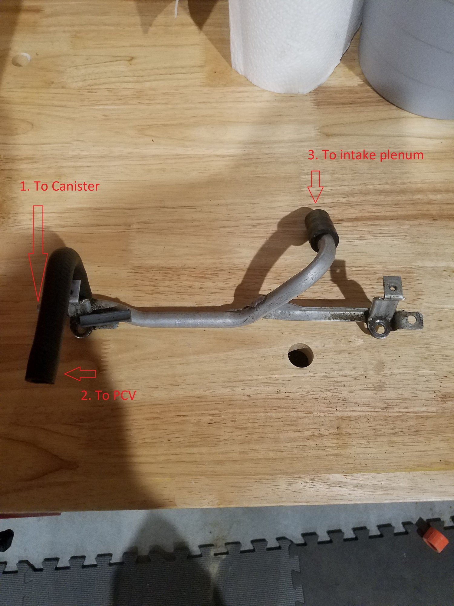

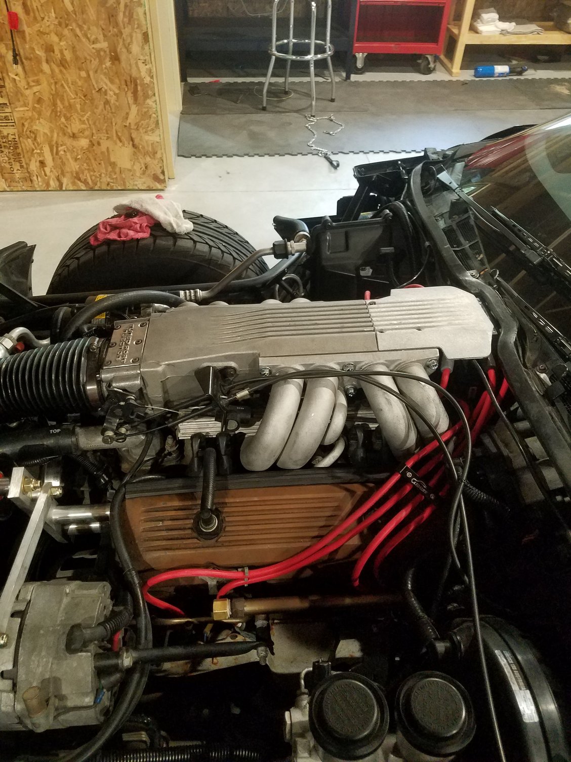

This is my 1985 before any of this... note the two vacuum lines running right behind the alternator. One of them goes to the throttle body, the other goes to a bracket hidden under the black cover over the fuel injectors...
Pull that cover, and underneath you will find the wiring for the injectors and this bracket:
For my car, I pulled the cover and the bracket. I was installing new, temporary chrome valve covers ($26 new, delivered from Spectre Performance on Ebay) at the same time so I can refinish my stock ones, so getting rid of it was easy. If you're NOT doing that, pull the vacuum line to the canister off and cap the tube. If you are pulling it, you will need some 3/8" hose (from the PCV) and some 1/2" hose (to the plenum) and an adaptor between them and you get this:
Please pardon the Bubba Brass fittings... they were available and 3/8" to 1/2" adaptors are hard to find. I have a 10 pack of them coming from Amazon... so... uhhhh… that's use one and 9 spares, just in case...
Finally, remove the vacuum line you just disconnected from the tube shared with the PCV and cap it off. I put a hose clamp on it just for giggles as a temporary "just in case" until I finish ripping the rest of this worthless garbage out...
There you go.
