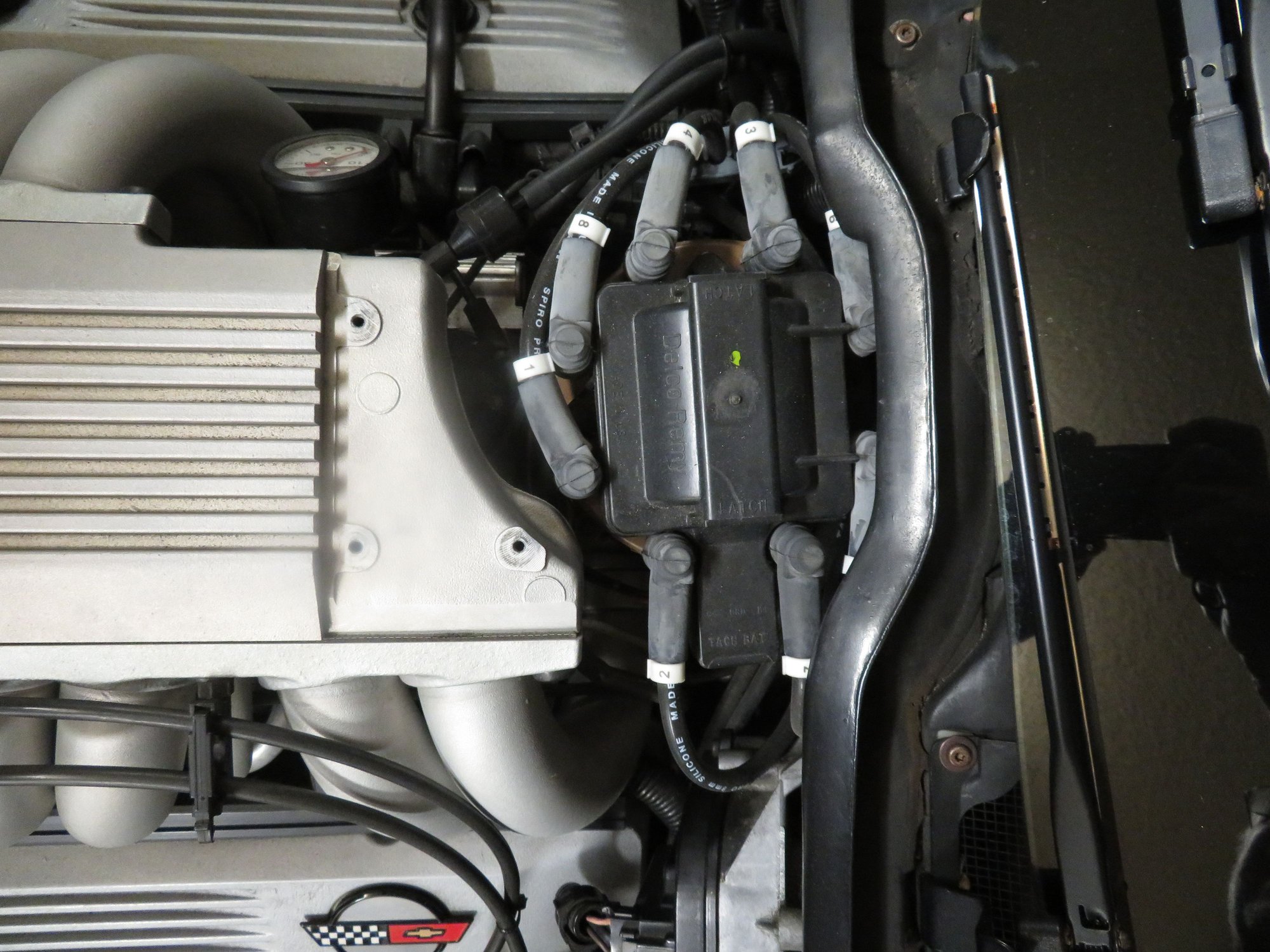

just for grins and giggles, here's my no muss, no fuss, method for setting static timing - engine at TDC #1 compression, and the slot on the oil pump shaft at approx. 5:30 position. drop the distributor in squarely - that is, the four distributor cap screws parallel, and perpendicular to the engine's centerline. the coil connections should come off, exactly 90° to the left, or LH side. as you lower the distributor and just before the gears engage, position the rotor exactly toward the center of the LH valve cover emblem (no emblem - an imaginary line between the VC's rear mounting screws - either perimeter of center bolt). it may take a little wiggle-giggle to engage the oil pump shaft, but continue to drop and seat the distributor. because of the helical gear cut and the 13 teeth on the drive gear, the rotor will automatically turn CW about 28°, and point to the #1 firing position at 0° TDC. once the distributor is seated, rotate the distributor a few degrees CCW - not much - every degree you rotate the distributor, is 2X at the crank. ideally, you should be able to get within a couple degrees of the factory setting 6° BTDC. note: this assumes the distributor drive gear is in the factory correct orientation or position - if it is turned 180° and installed, that throws the whole thing off about 14°. if it's upside down, forget it -you'll never get it started - . there is only one correct, factory position when installing the distributor. install the cap and wires in the proper order - once started, grab a timing light and fine tune - for some reason, these things seem to run real good at 7 or 8° BTDC -
ideally when you're finished, your distributor orientation should look like this - L98 tuned port - L83's will differ . L83's may differ....

The only way the L83 will differ, is that the #1 plug wire routs directly to the LH side of the engine, rather than wrapping around the back of the distributor, as shown here
