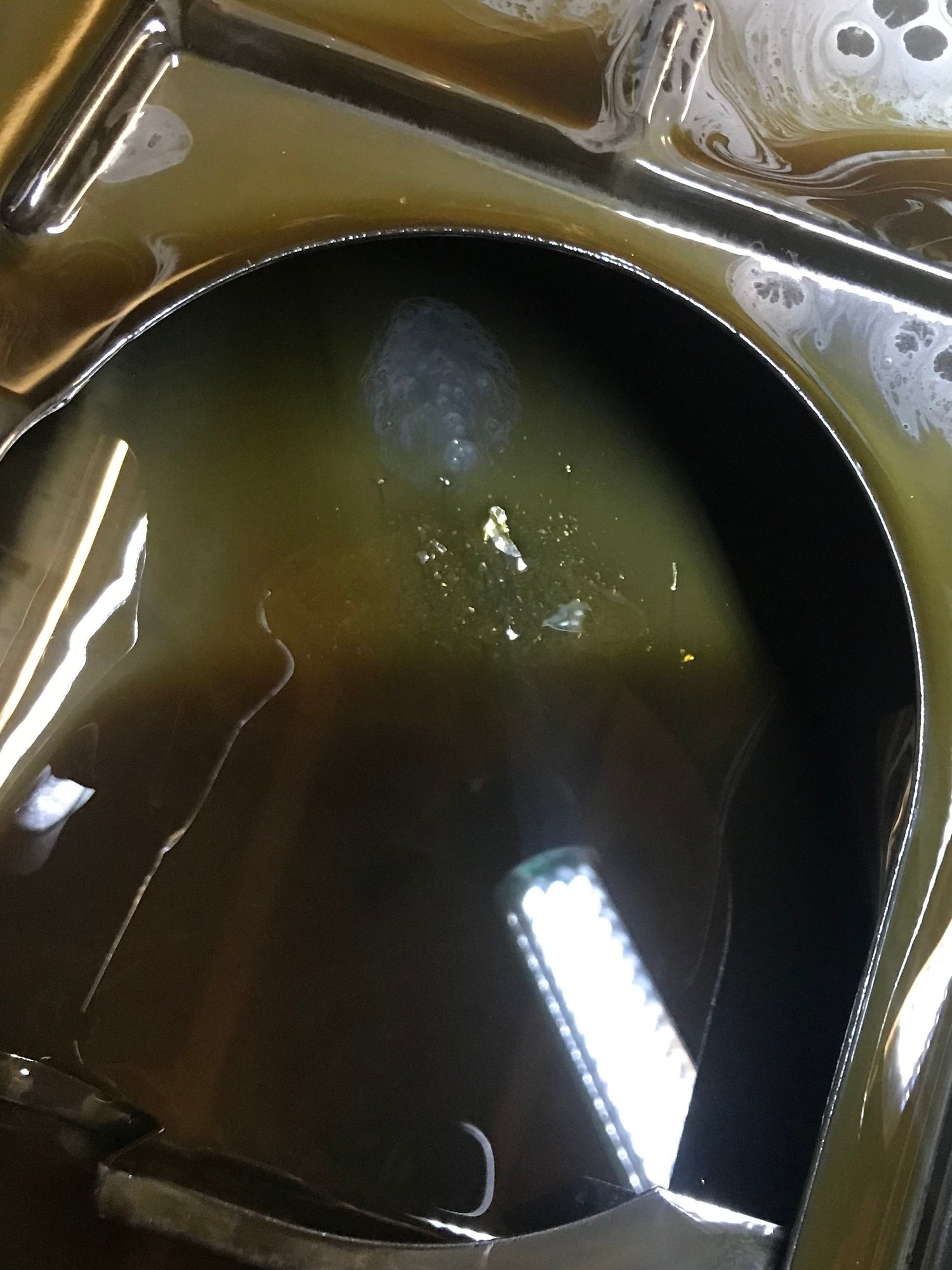

Well it was bound to happen at some point....Motor has just under 100k and has been well maintained over the years, but couldn't take my spirited street driving anymore
Couple weeks back went WOT 1-4 and noticed an audible knock above 2500rpm after. Still had strong oil pressure and was not down on power so I thought a rocker came loose or a valve spring broke. Finally got it up on the lift today, pulled the pan and found LOTS of metal. There was even metal between the oil filter adapter housing and block. Pics below are from inside the pan.
Haven't had a chance to pull plugs and spin the motor to inspect each bearing, but pretty sure one or more of them spun.
So what to do next is the question? I'm know everyone will say build a 383/396 but not sure if that's how I want to go with this car mostly from a financial perspective. I've been looking for a new fun car that the kiddo can ride in (Chevy SS sedan, Gen5 Camaro ZL1) so i'd like to keep the rebuild cost down. Assuming a new crank needs to be purchased anyway how much more would a 383 build run? Curious to see what others have done in this position.

After digging deeper this weekend I found the #8 rod bearing to be toasted.
As mentioned the bearing could probably be replaced in vehicle, but I only see this as a band-aid fix. Since it's not a DD and just a weekend car i'll take my time to repair it correctly. Two ways I leaning right now with a slim margin of victory going to option 2.
1) 383 build - rotating assembly, machine work, good set of heads (probably AFR's), neutral balance flywheel, new clutch, injectors, yada, yada. It would be BA but i'm EASILY looking at 5k+ for something like this.
2) 350 - new crank (possibly new rod on #8?) and a nice ported head/cam package from AI or EP. Cost would be much less, probably half. The other option here is to do a 355 to clean up cylinders and go with an entire new rotating assembly.
Not in a rush so i've got some time to think it out, but open to any experiences other forum members have had.

The more I thougth about it, I think there are other issues going on. Based on the oil condtion (which was replaced earlier this year) you can see it looks a bit funky. Thinking a bit of coolant was getting in the oil and diluting it's lubrication. Oil had a faint gas smell too so a leaky injector could have contributed as well. Conbine that with high reving and we may have a cause.
