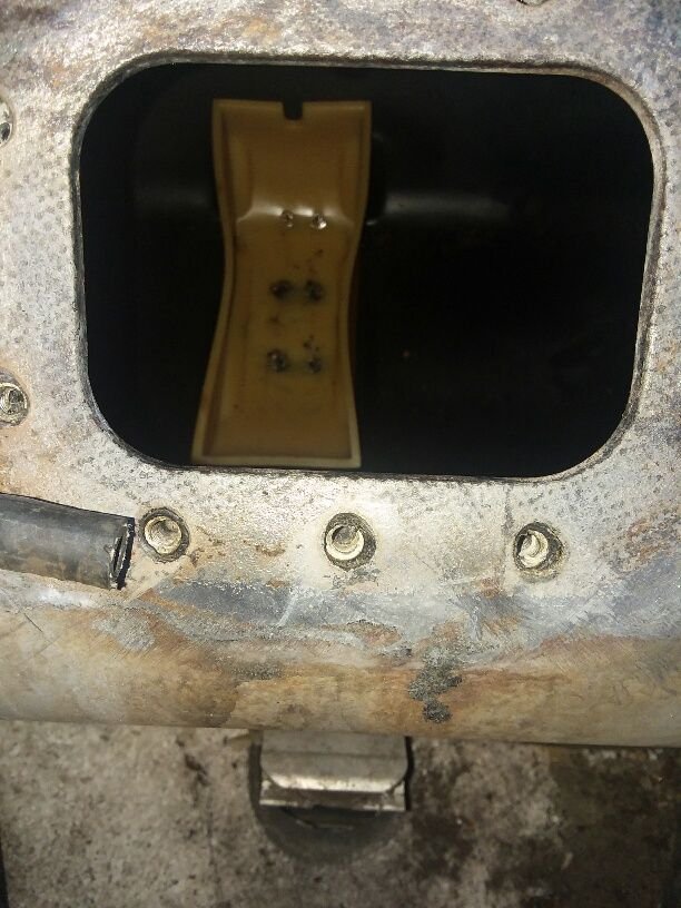

I drained the tank yesterday and cleaned the bottom of the tank with an old tee shirt. Noticed that there is a plastic thing attached to the bottom. Is this where the fuel strainer sits ? I didn't notice it as I pulled the sender out .
Don
It could be the sump if it has straight lines. Take a picture

Yes, a white plastic thing attached to the bottom.
Front to back .with short sides
.i can get pictures after work .
Don

Sounds like the pump baffle and if it sticks to the tank, life is good

Old Sep 20, 2019 | 09:44 AM

That is your baffle. It keeps fuel available for when you do corners

So, the fuel filter sits down inside this baffle ? Long end to the back or to the front ?
BTW. . . I like your Avitar
Don
I believe so.
