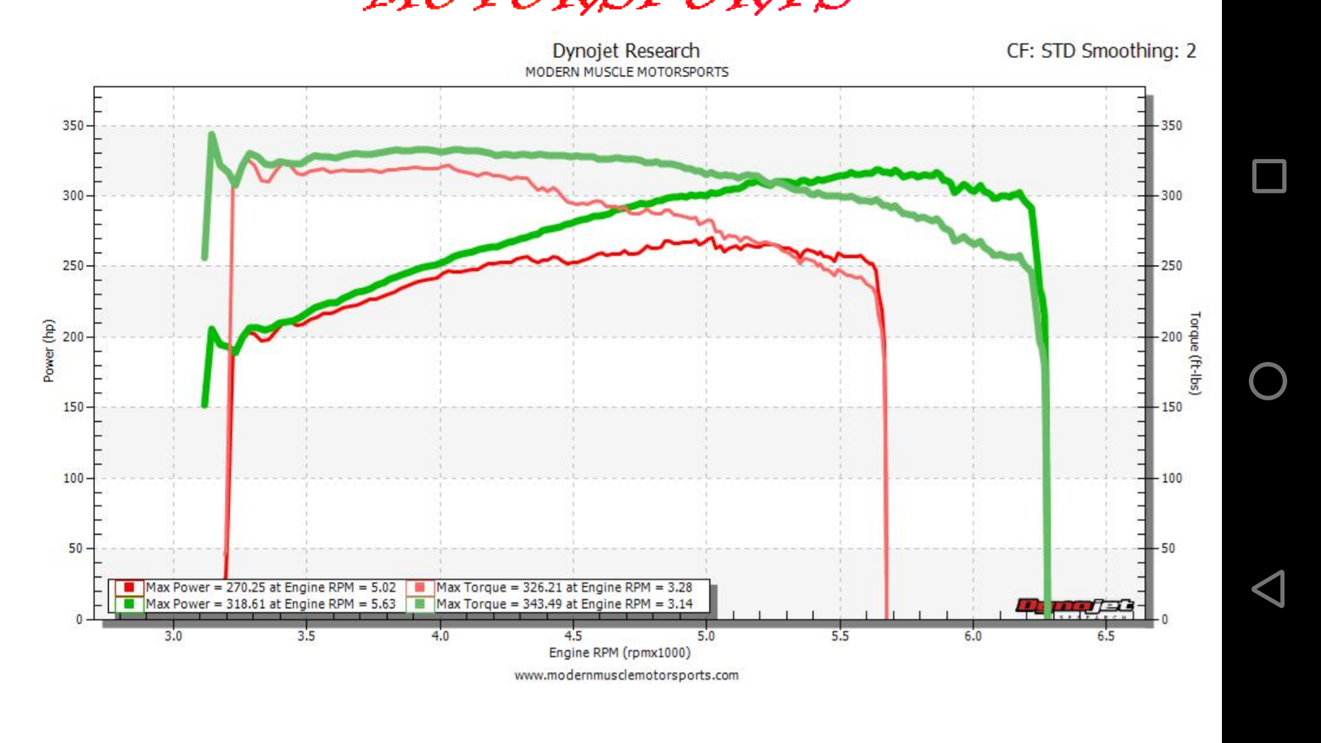

Agree, If you don't know talk to LLoyd. he is an expert and willing to help every step of the way. he ground my cam and called it at 50 hp gain and hit it spot on.
Before and after cam swap
