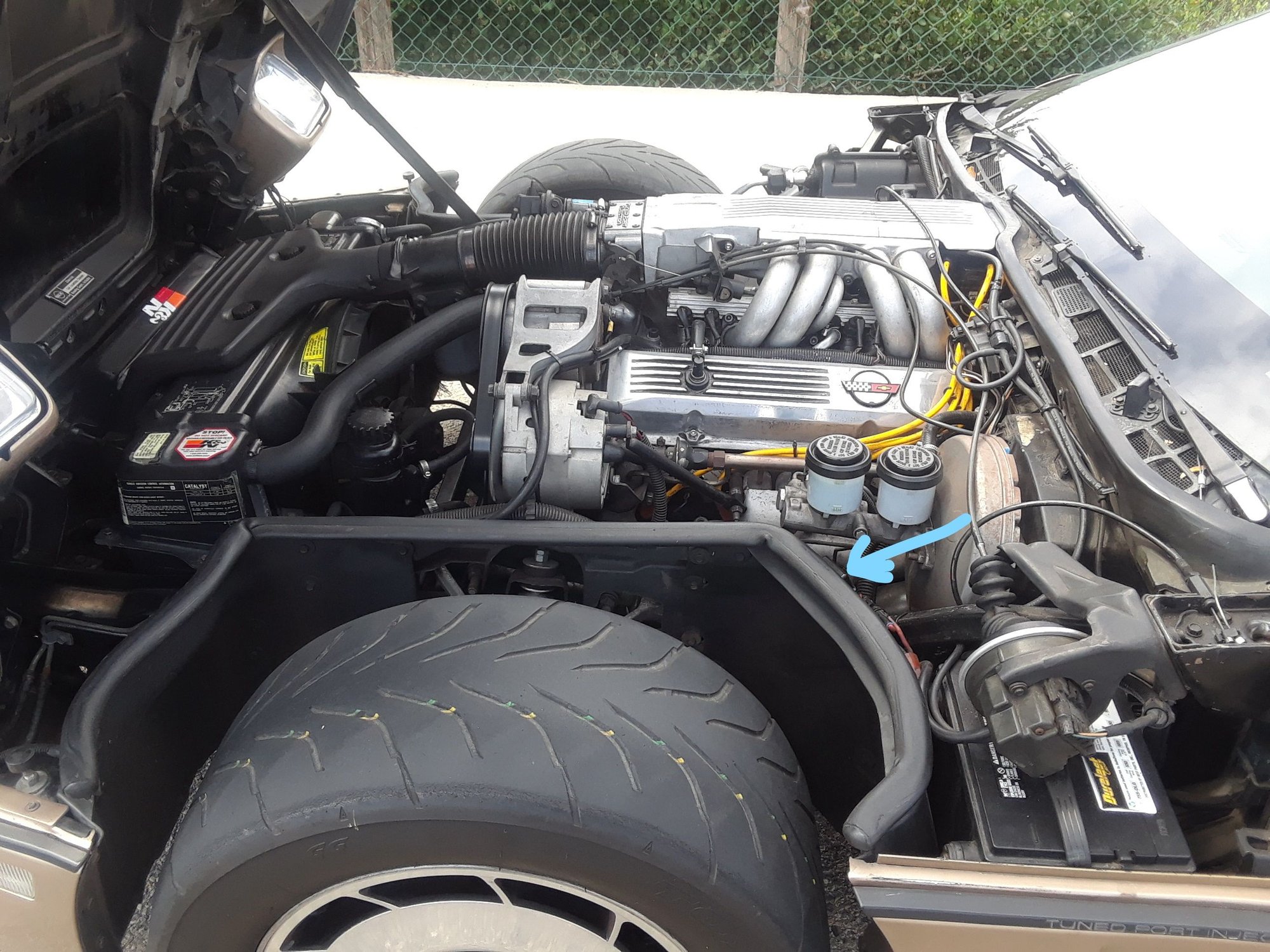

Here is the main fan relay . You may have the same problem as I had, the plastic coating shrinks down allowing the wires to touch, check all your wiring for this.
wiring seems fine. i check further when i replace the relay. thanks
