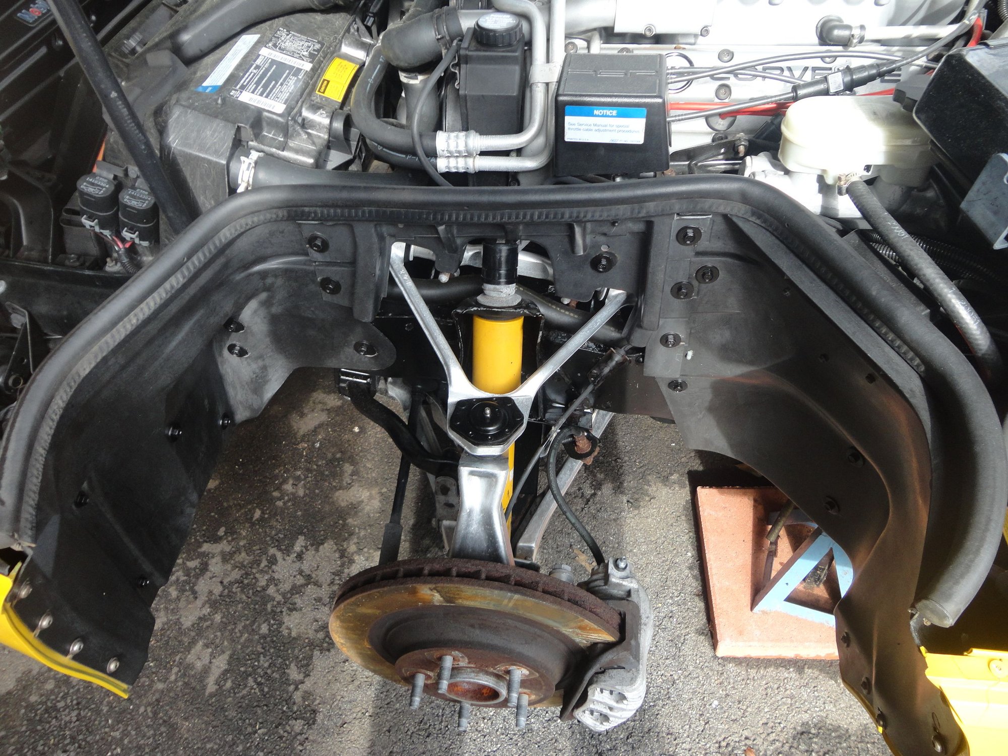

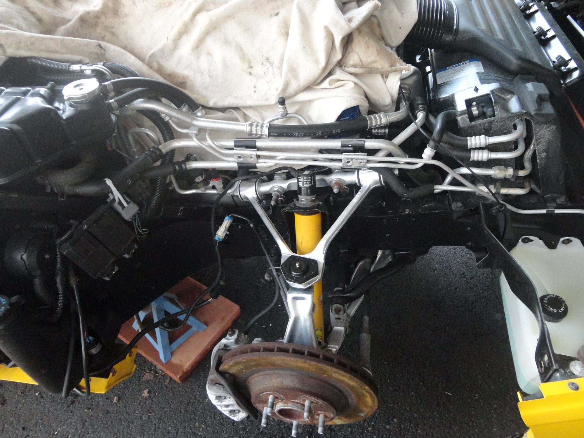

Remove everything you can and clean away. bag and label screws and bolts take pictures. I used light greaser and low pressure washer.

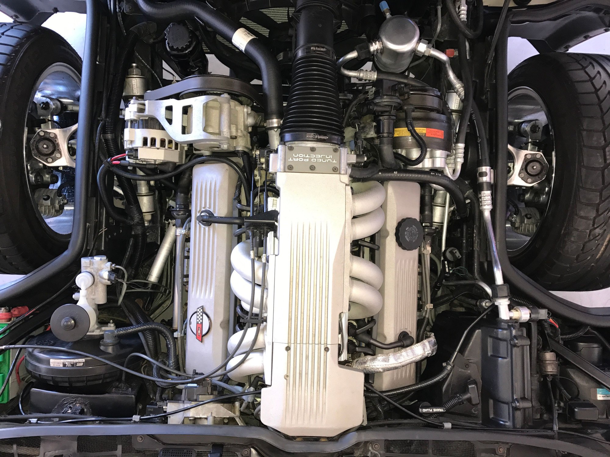

Lots of good suggestions. Let me add my .02.... In my experience, you wont ever get ALL of the grime off is one pass. It takes a combination of different chemicals, brushes, cloths, abrasives etc. to get a professional result. Take it in steps and a little at a time. It takes me about 3 to 4 months of many trips to the garage. I am fortunate enough to have a lift to work on which really makes it easier to get everywhere you need to. I like doing the underside and all of the engine front to back, top to bottom. Once everything is totally de-greased and clean, you can break out the spray paint and start touching up where needed.
With a pressure washer, it takes less than an hour.
You're engine bay looks fantastic...but I don't see how it's any better than mine.
